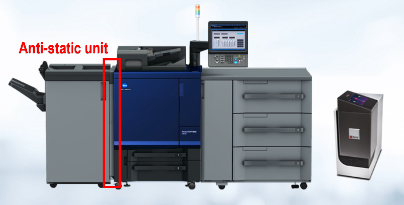

Before Konica Minolta started including a built-in anti-static unit in all of their production units (see image below), many print shops would use anti-static tinsel in their printers. I'd suggest working with your service tech on the best place to put it in the machine that won't cause jams or sensors to go off.
