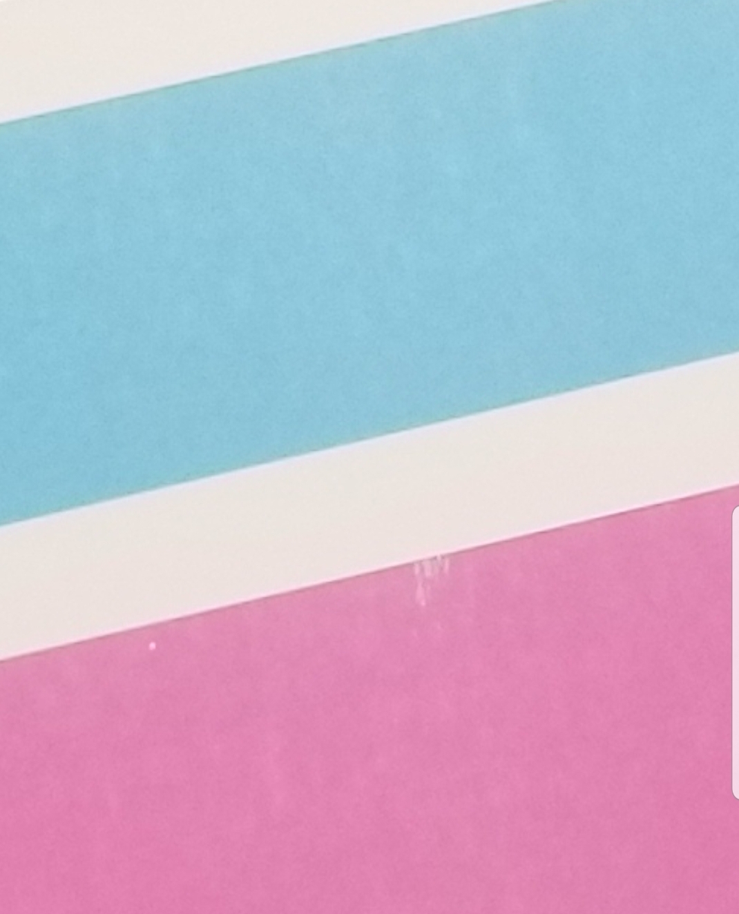

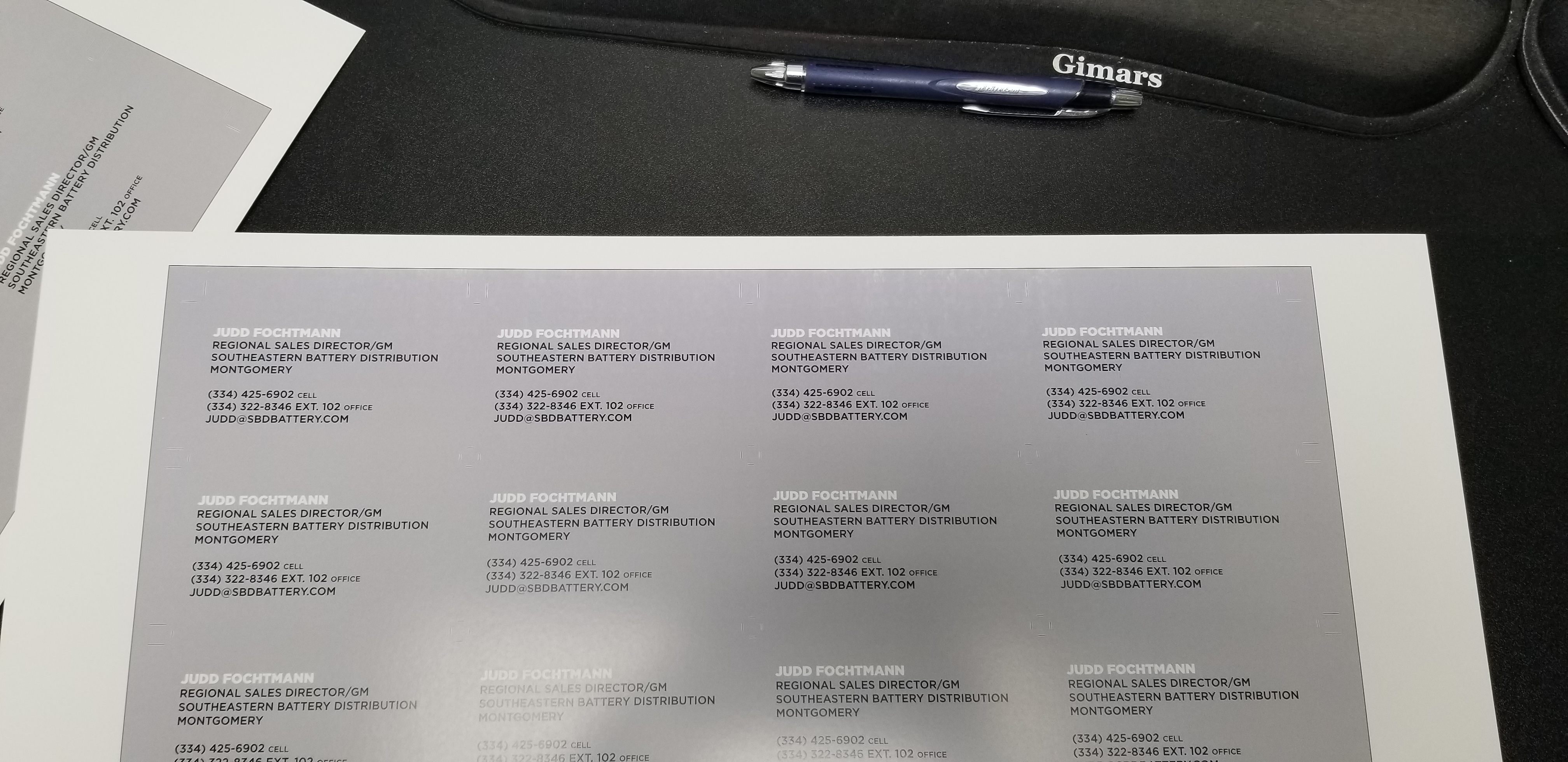

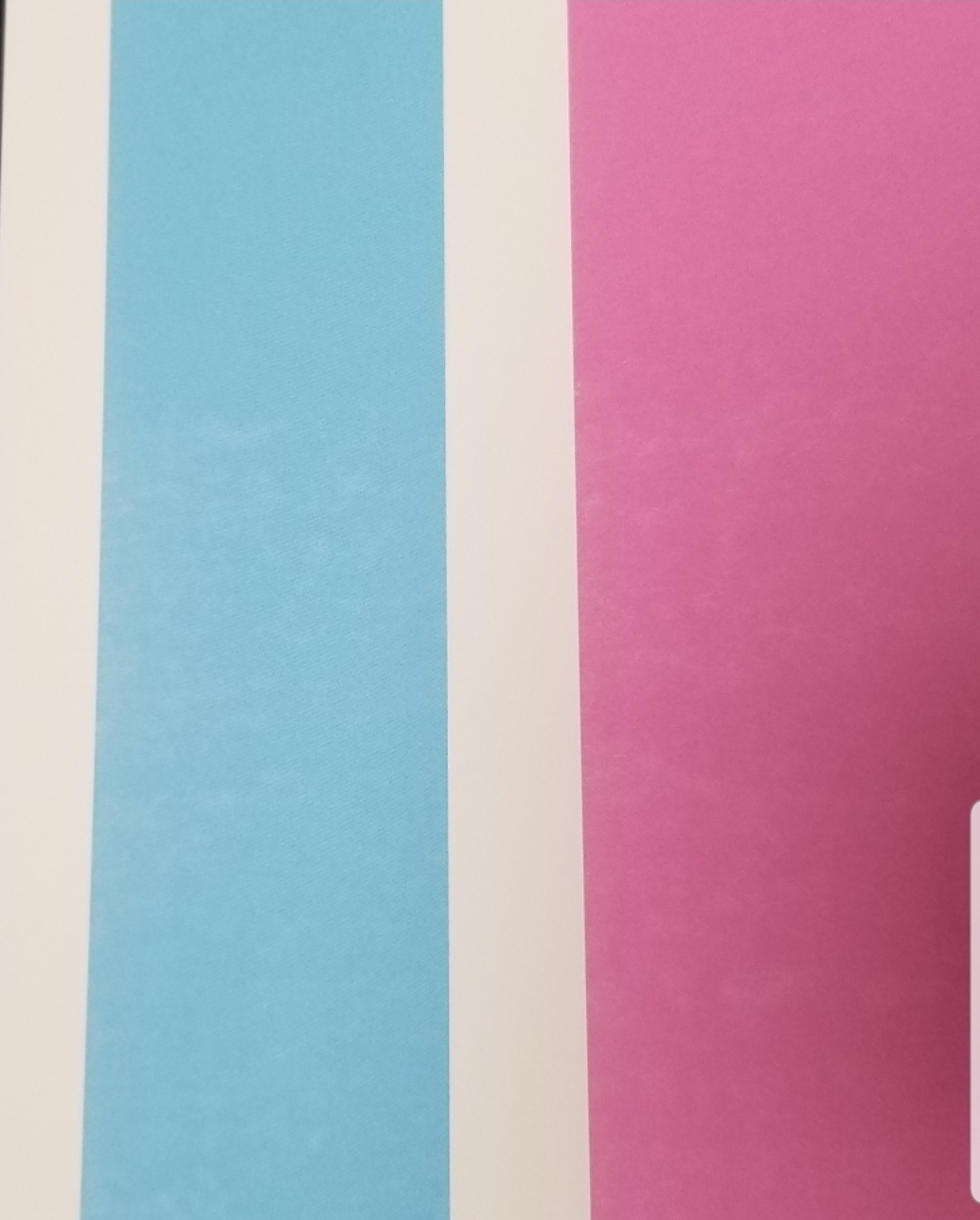

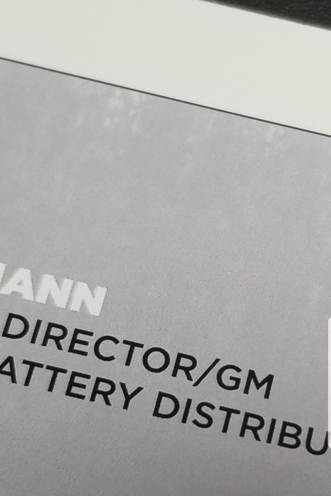

I'm having an issue with the color fading on the edge of certain colors. I've mostly noticed it on gray colors and I think I've seen this issue before with my C7200 and we just usually ran the press long enough to "heat it up" and the fading would go away.
However that trick doesn't seem to be working this time. I printed some test sheets and all the solid 100% colors look fine, it's mostly the half tone 50% test sheets, magenta and cyan that show it the most. My Ricoh tech was here last week and did PM and replaced a ton of things and it still didn't help.
I've tried several different paper settings. It's mostly happening on gloss cover or synthetic vinyl 14 mil (expensive) sheets. It's mostly at the edge, the top in this instance, the right on the other cards I'm printing. It's also occurring on the backside in the same position.
Any ideas or insights would be greatly appreciated.

I would guess transfer rollers, do you know if those were replaced? You can try and adjust image transfer and or paper transfer.
The 7200 could print the 14mil all day. The C9210 is rated for it.
I tried some skilled operator adjustments and that didn't help.
Then I decided to delete the paper from my catalog and try one from the paper library and that seemed to do the trick. No splotches now on the 130# gloss cover. I'll have to try to find something in the library for the 14 mil and see if that works better. I'm guessing when I set those paper types up, I didn't find it in the library and just made my own choosing the weight, gloss, size, etc. The library must have more in-depth settings.
Thanks for your feedback and help!
If you go into the "Advanced" paper settings for the particular paper you are using there is a setting to adjust the NIP roller. If you turn it down it will take care of that most of the time. We had the same issue on 24pt. C2S and when we turned down the NIP to level 1 it went away.
Thank you, I have some 14 mil business cards coming up. I'll give that a try!
We had issues with synthetic stocks on our 9110 and I had to go in and adjust some transfer voltage values in order to get good coverage. Nip adjustments could also help.
