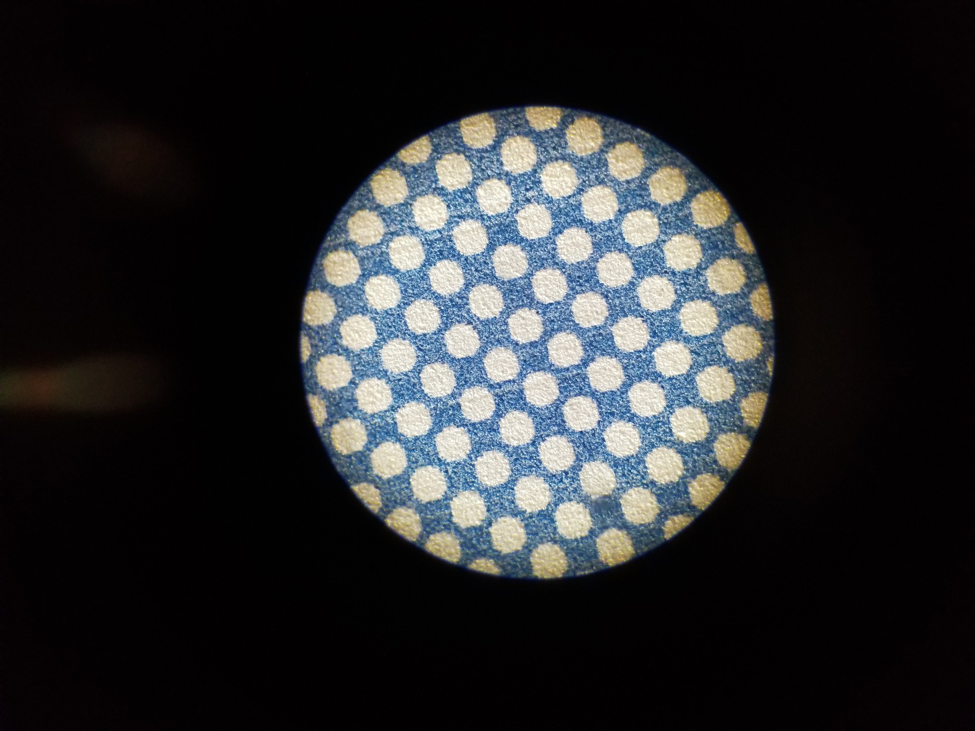

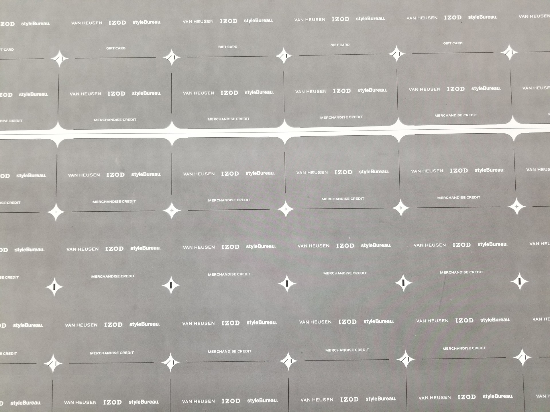

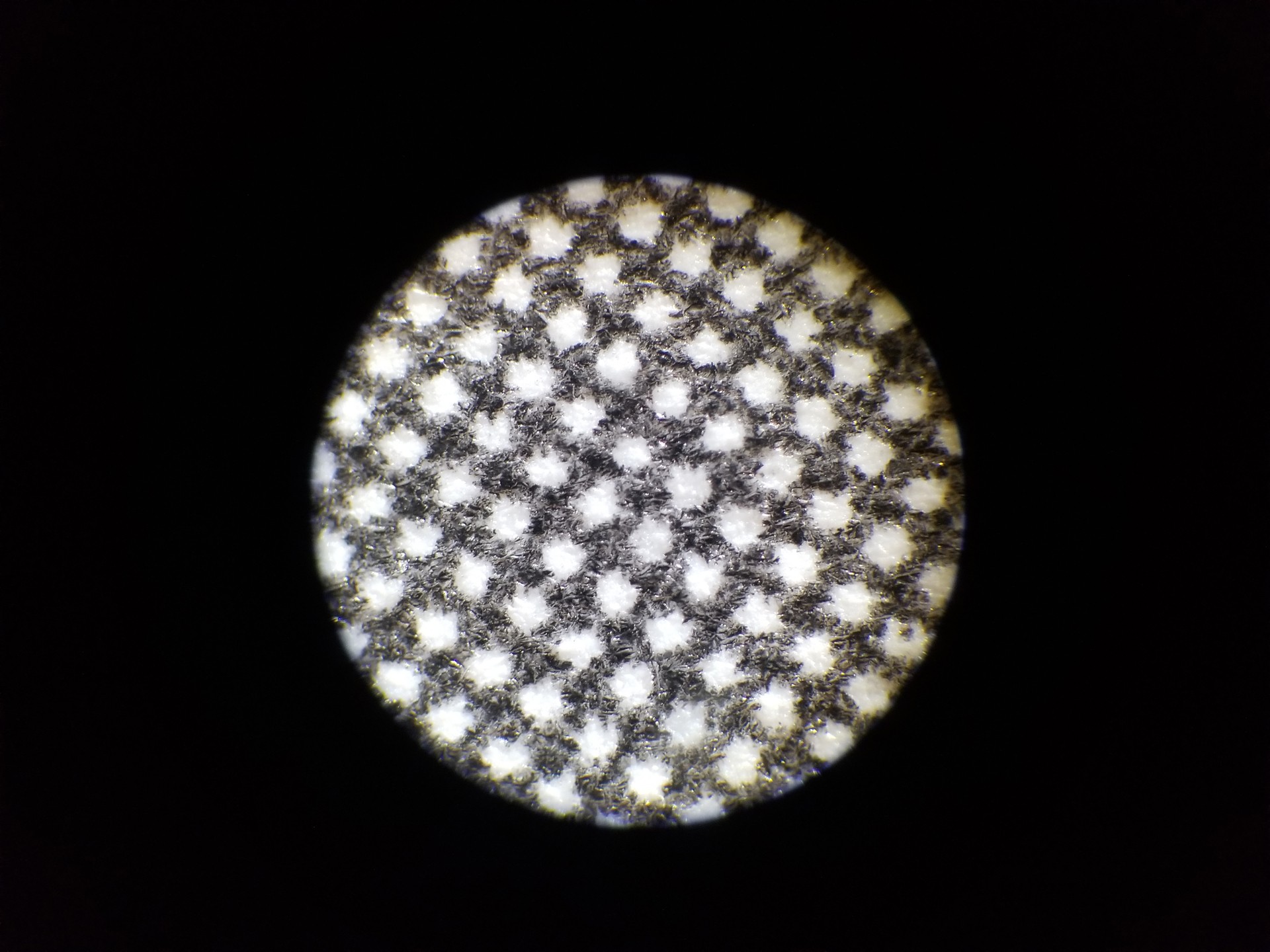

We are having some issues with print quality. We are trying to print a 60% black screen and what we are seeing is best described as blotchy or lighter and darker areas in the print. I have examined the dot with a microscope (see attached pics) and it looks nice and sharp on the plate but not so good on the press sheet. I am wondering if this could be coming from our Kodak Trendsetter 400? I have noticed this on 2 different presses. I have tried cleaning the plate processor, running job through a different profile, I have tried 175 line screen, 20 Micron Stacatto and I get the same result on everything. I just want to rule out anything in prepress that could cause this issue. We are seeing this in screens around the 40 to 60% range. The press is convinced the problem is in prepress, but I can't find the problem in any of the equipment. If the dot is good on the plate, shouldn't it be good on the press sheet? What am I missing? See attached pics for what we are seeing. Thanks in advance!

Could this be an issue with the laser head on the Trendsetter 400? Anyone have any experience with what happens when the lens or mirror is dirty? What would I see if this was the case? I don't know, I just keep going back to the picture of the dots. I can't understand why the dot on the printed sheet looks like that when the dot on the plate looks clean.
Unless they've made a radical design change the Trendsetter 400 does not have a mirror.

Looking at the dots suggests (to me anyway) that they may be running too much water (ragged edges of dots and low K density).
Is it just me or is that the grainiest or most fibrous pvc ever? Great pics, btw. (and please excuse my ignorance; I have never printed on such a substrate, but we do occasionally print on credit cards and they are very smooth even when viewed at 100x)
But, seems like ink would look that way based on the close-up pic of it.
Anyway, also looks like press banding, as if from rollers.
Have never seen that "effect" from the Trendsetter or any other image setter. I'm assuming the top and bottom of press sheet pic is trailing and leading edge.
Issues from lasers on plates usually runs east to west, in the direction of laser travel. And usually the resulting pattern is quite uniform.
The pattern on this sheet is similar to a few things: roller chatter, bad stripes, and/or a few other things related to same.

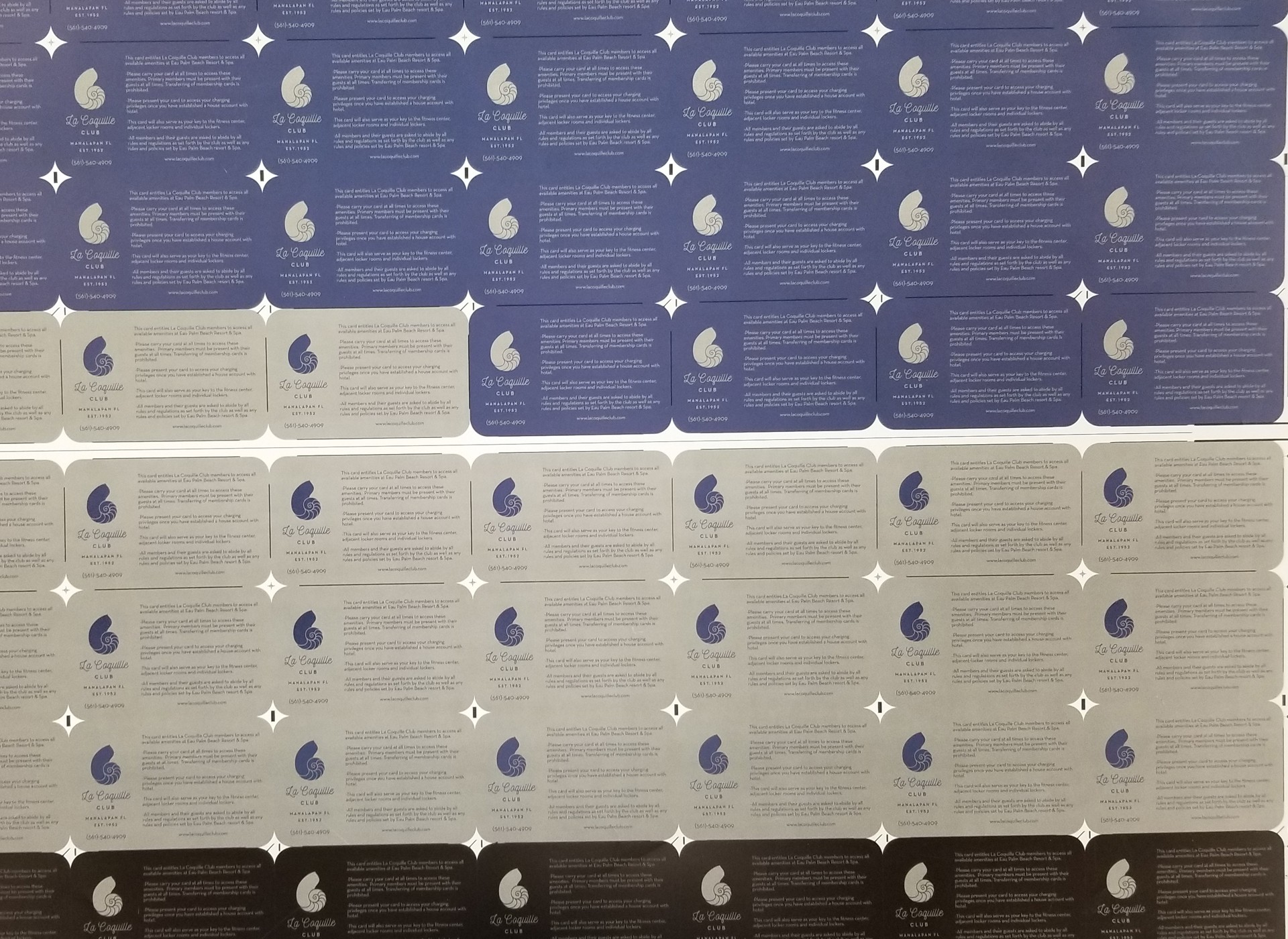

I have attached a picture of a job that was ran the day before this problem popped up. The gray screen is 50%, it looks nice and smooth. The only difference was this was ran on .06 mil. There was an issue with one of the files (some text was overprinting on the black card) and I had to remake the plates. When they put the revised plates on the next day, it looked blotchy like the other job in question. So this shows that we were printing cleaner, I just can't figure out what changed.

1) have the plates previously had that slight blotchy look to them? Your picture shows an uneven colour on the plate dot.
2) Has the operator loaded fresh ink in, washed up and started water dials below scum point?
Your press sheet dot looks like serverly emulsified ink which can easily be done if water dials are left where they normally run on paper stocks or the ink has been left in the ink duct and continuously sprayed with anti skin each night.
