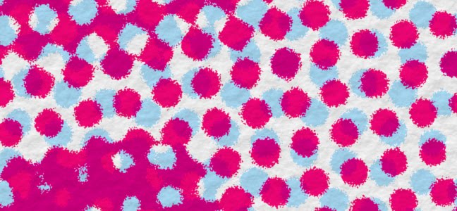

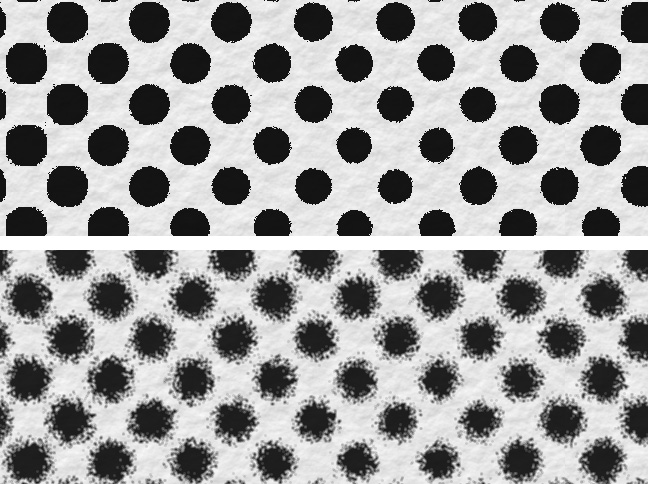

Next is halftone dot formation.
Halftone dots can reveal issues such as dot doubling that may be the result of loose or incorrect blanket packing.

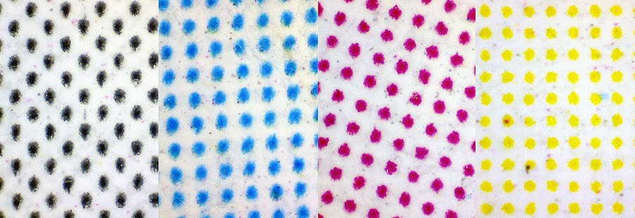

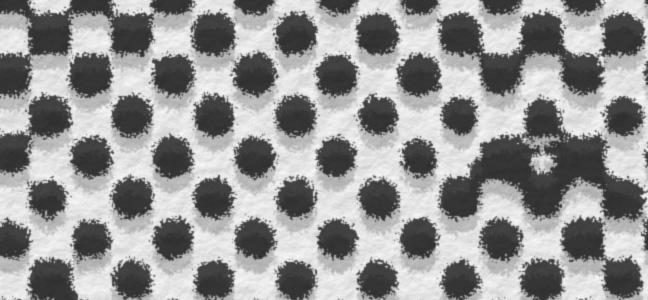

Here speckles of ink indicate there may be a problem with the plate processor. Also, in this case, the black printer is, because of the elongation of the dots, showing a problem with slurring.
The amount and type of halftone dot distortion can reveal problems with ink water balance as well as the condition of the fountain solution.
When halftone dots are the same size and should be the same approximate density as in the case of Cyan and Magenta - but aren't - this can signal a problem with the solid ink density or an ink/water imbalance.

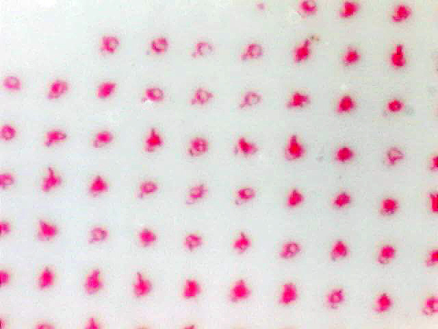

Pinholes forming inside halftone dots can signal a calcium carbonate issue.
