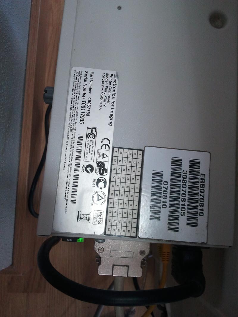

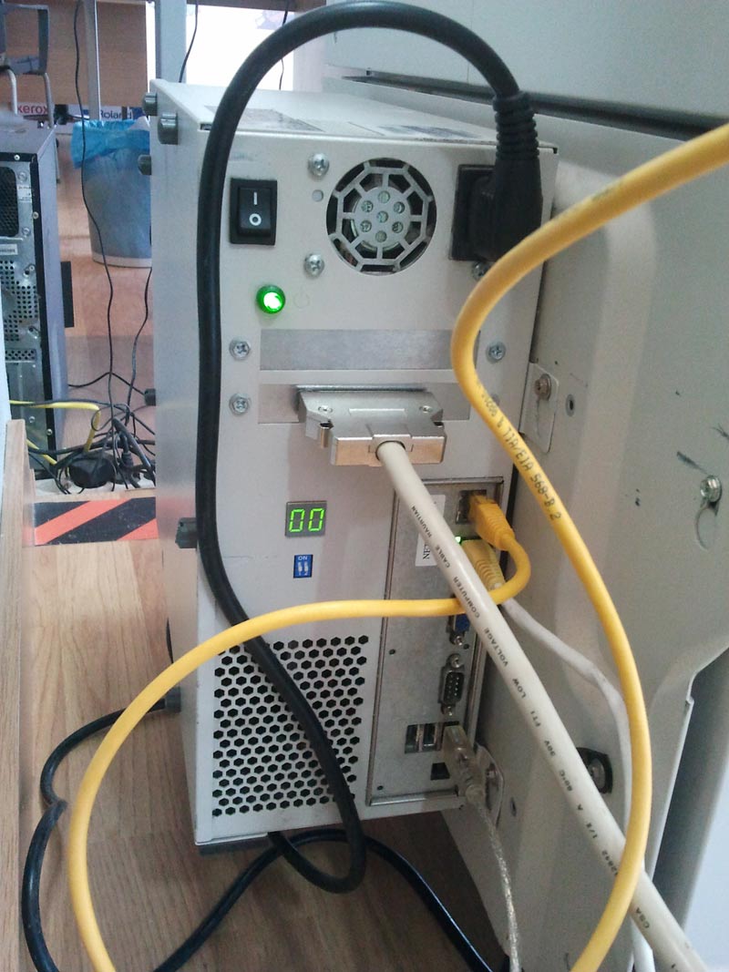

I cant get to the icon to print the configuration page to see the IP to be able to connect...also I cant see the TCP config icon on the control panel of the DC260... I have attached a photo of the fiery box, the ethernet cable led is not on.. seems that there is no connection.

on our 260 the ethernet cable is very finicky, has to be wiggled for it to connect, you should see a green light when the network end of things is going. Not sure if that has anything to do with your problem though.
I have attached a terrible picture, not easy to get at the back of our old 260. But you see both lights on for "Net" and "Scan" Sometimes the light would be off, a gentle wiggle of the cable would bring it back again.
