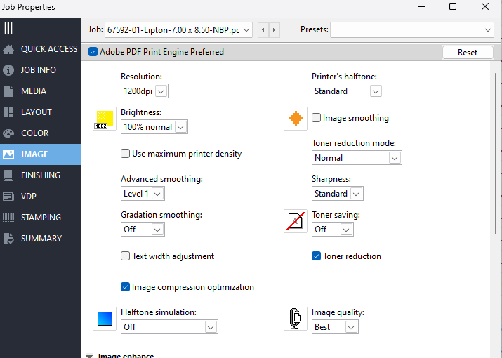

There are a host of options in the Fiery to lower the brightness/toner usage etc. There's also a page where you can set the defaults if you find a setting you prefer to start with as your baseline.
I do not believe there are options to turn it down on the machine as a whole, it's kindof a Xerox thing where all the colors are a bit dense and oversaturated.

- Thanks Ttngcas, I'll have a look at the Brightness setting, presumably that will lower toner density....?
