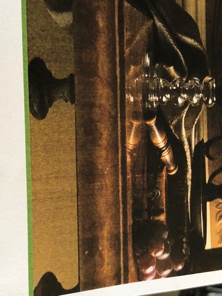

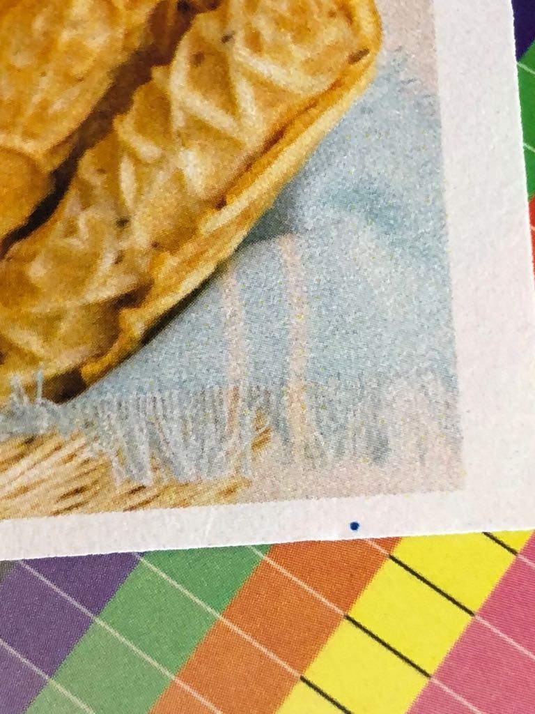

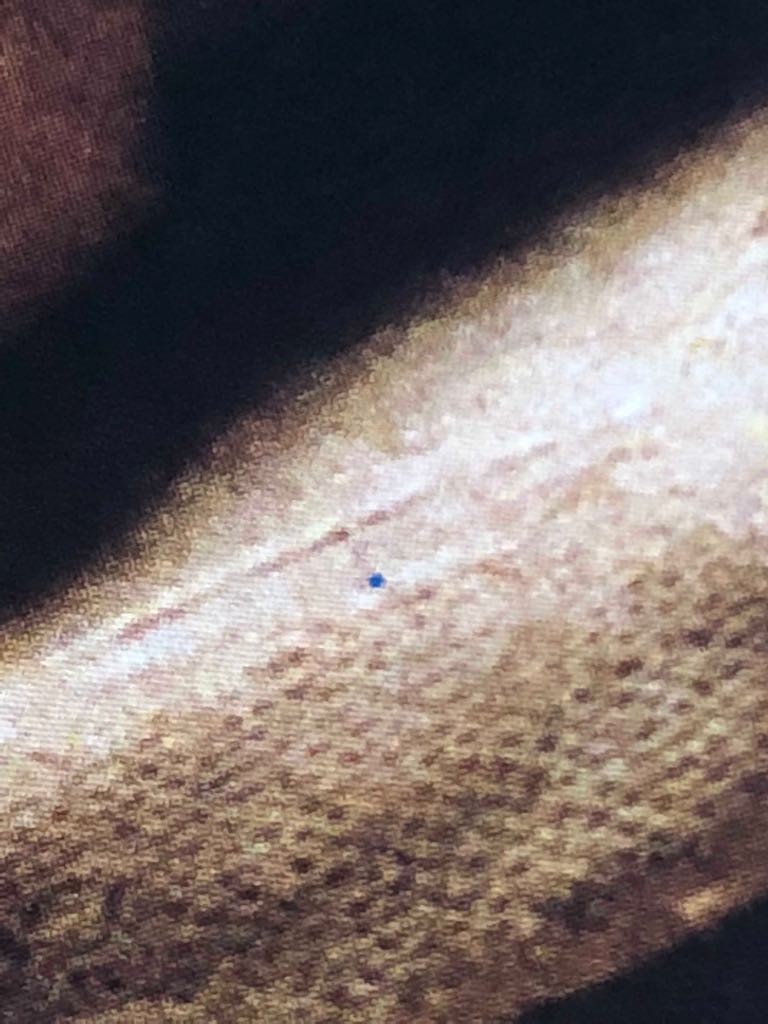

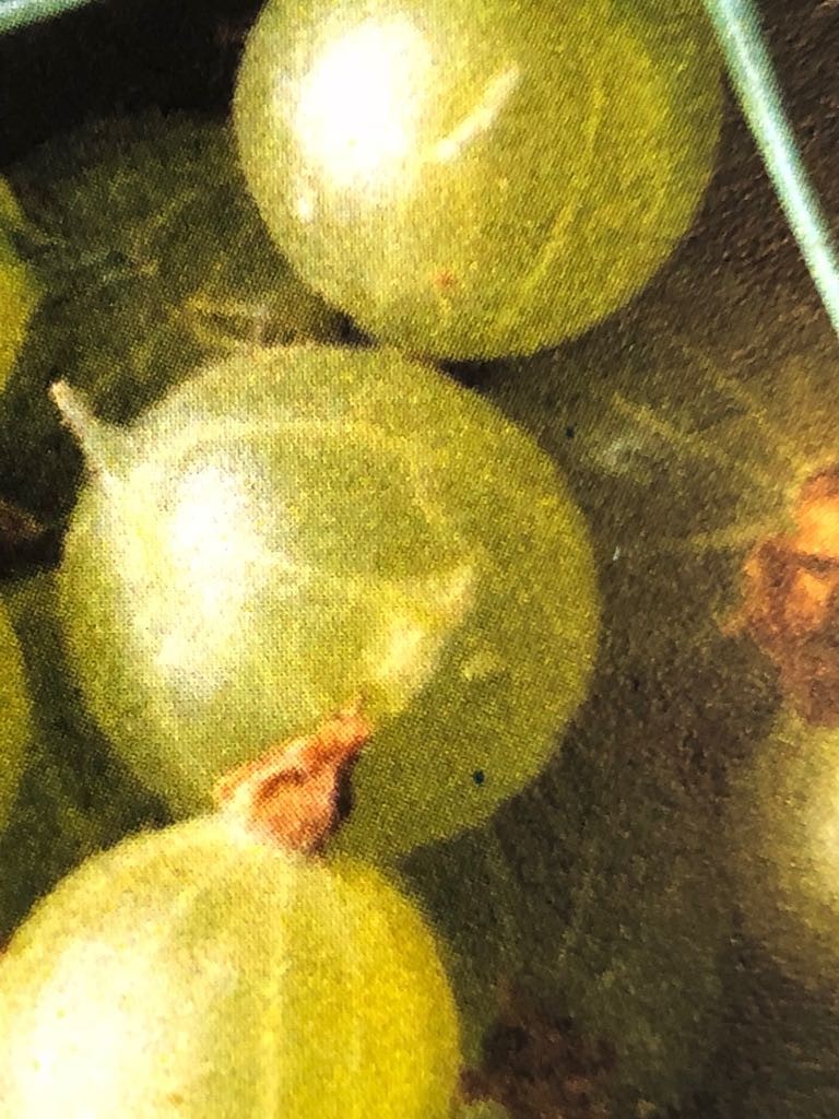

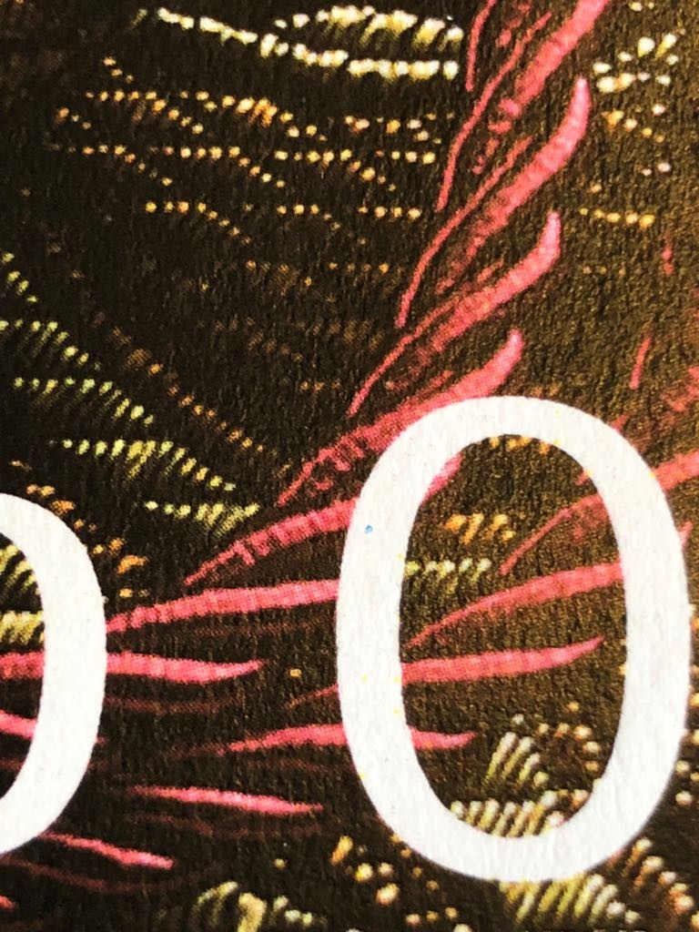

Hi guys, I've been lurking on these forums, and so far, the information on the *** has been great! I'm currently purchasing one but I've been skeptical of the units. I've seen some units with 90K impressions to 750K, but I can't seem to find something I'm comfortable with. (First machine I'm purchasing) A sample print was sent to me, but there were blue dots all over randomly on each page, and on the test sheets, some colors seemed cloudy? Anyways, the pictures are attached, I'd love some input, thanks in advance!

The blue dots are either a nick in the blue drum or errant toner globs hanging around in the paper path before the fuser. The latter fall from the drums/developer units and are fixed by just cleaning the paper path. The drums can be swapped out easily if there is a problem as well. Not sure what you mean by cloudy, but we've had great luck selling our prints.
We've had two of them for a couple years now. One currently has 1.7m on it the other 330k, both purchased as floor models from Xerox demo rooms. Both loaded with Fiery controllers and booklet/square folders.
I didn't see any problems on your pictures that couldn't be solved with a service call and or user adjustment. They might not compare to a high-end machine but I have compared other models like the 1000 and Versant and I would be willing to bet that most customers would never know the difference.
