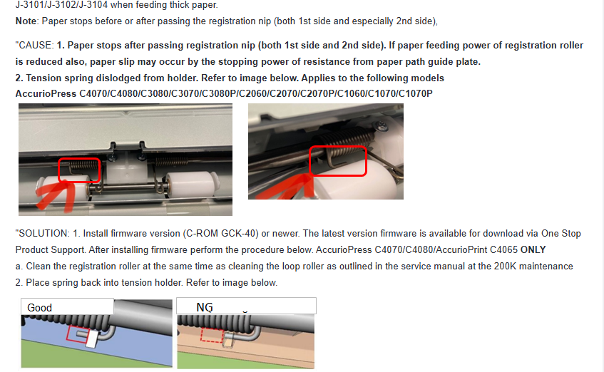

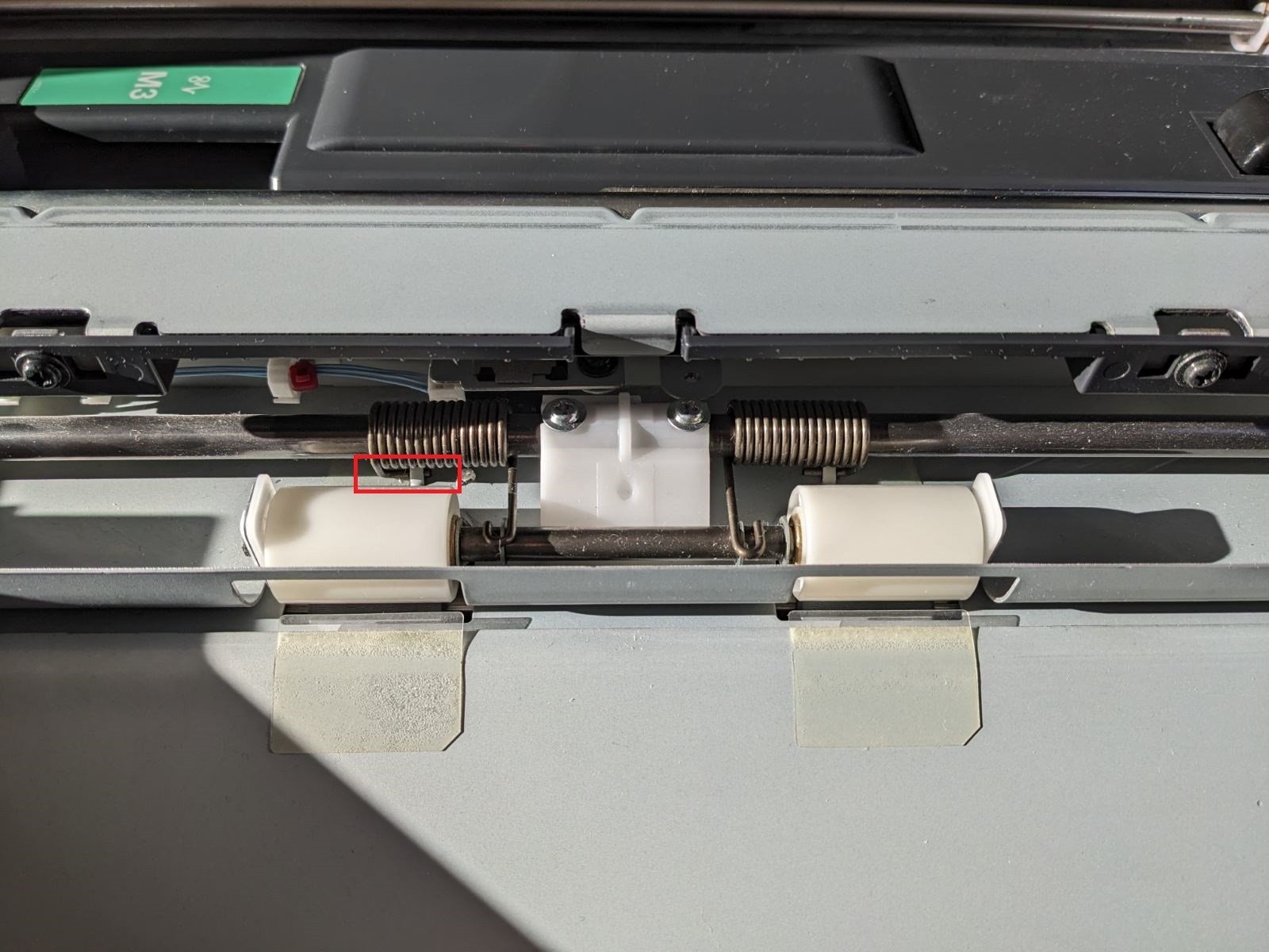

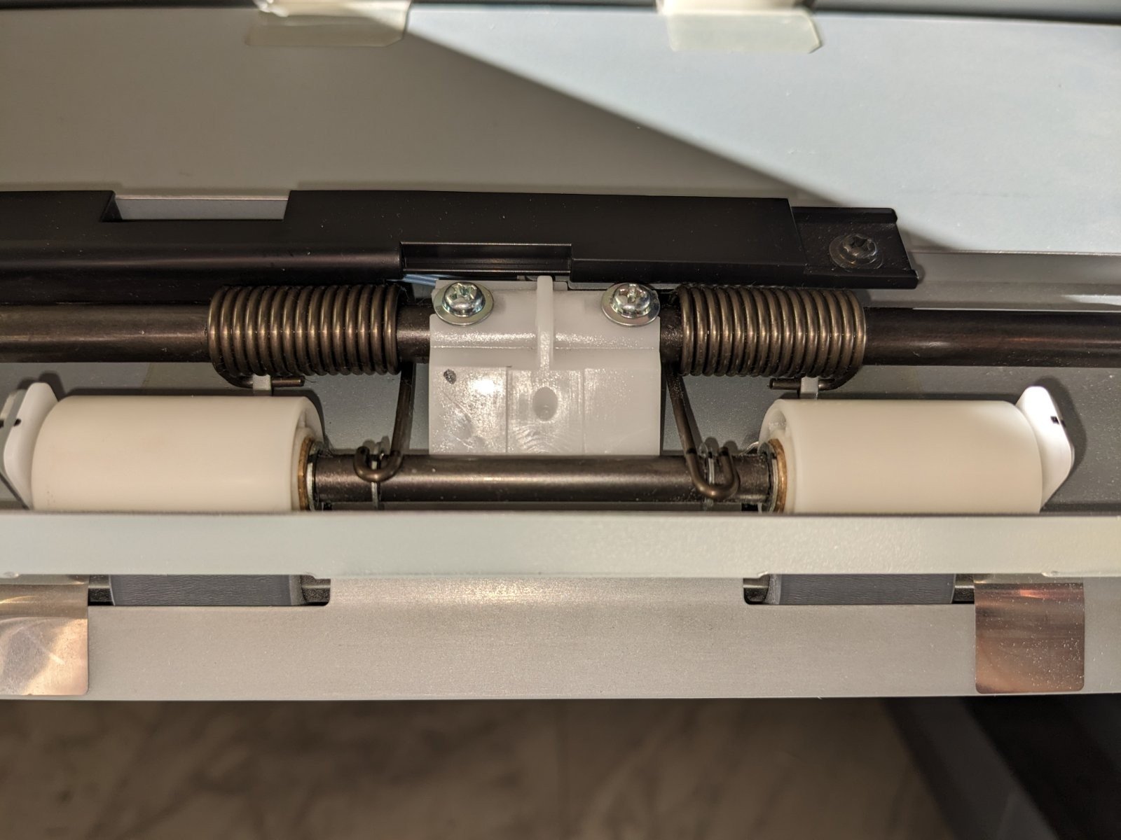

Just an FYI, I was given this suggestion, one of the springs on my press was a bit dislodged, I put everything back to where it was supposed to be but it still did it again today... Guess I'll have to take the reg unit apart to investigate.

I seem to have found the issue (fingers crossed).

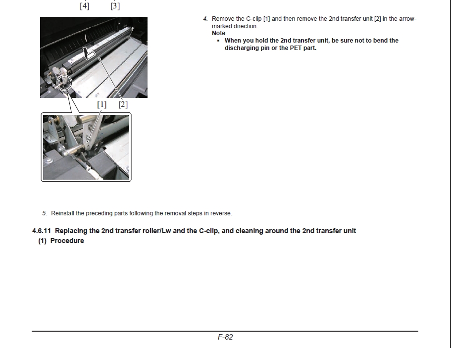

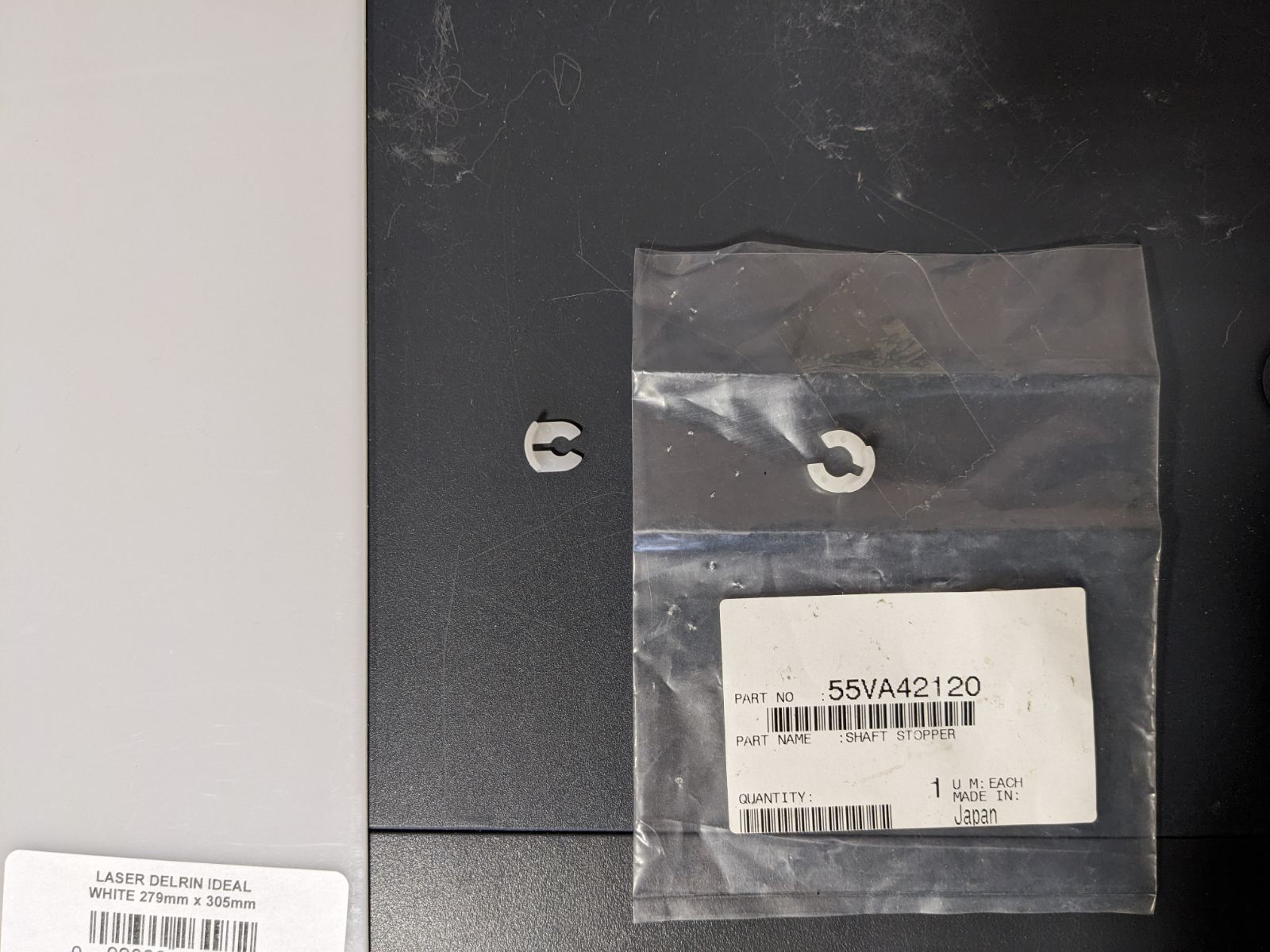

Someone had installed the larger clip that you see on the right (55VA42120 SHAFT STOPPER) instead of the smaller one in the left (can't remember the P/N but it's SHAFT STOPPER /4) in the groove that holds the 2nd transfer unit in place. The larger clip, rather predictably, didn't fit in the groove in the shaft that the 2nd transfer unit slides onto properly, causing excessive slack/movement of the 2nd transfer unit.
I suppose with thinner stocks this wasn't much of an issue but with the 300/350 gsm stock is when issues arose.
I've since replaced it with the proper one and so far no issues... Only time will tell if it's gone for good!
