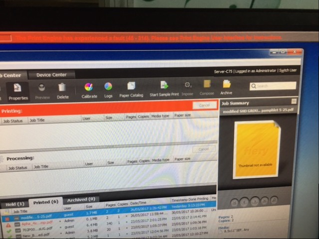

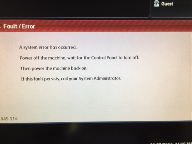

Just changed the yellow wiper developer seal blade (on the developer unit) as I it was damaged on my C75, now machine won't print!
Message: "print engine has experienced a fault (45-314) please see print engine user face for instructions".
See attached screen shots.
Any suggestions would greatly help.

I had a similar issue on my C75 last night. Problem is, I am not at my shop right now and I don't remember what the error code was. I'm pretty sure it was three hundred something. I do remember the tech telling me when I called that it is related to the drum motor. He said it doesn't take much resistance to throw that code. He said my code was for the black drum. Sure enough, when I pulled it out, it dumped toner all over the place and had a streak around it about a half inch wide. Something must of got caught in the wiper. When I replace the drum, code went away and it worked fine. So I would imagine you may have over-tightened something or whatever. Try going back over what you did. Make sure nothing got caught and it's put back together correctly. I wish I remembered what that code was though.
Good morning Keith, than you for your suggestion. i think that is the area of the issue, the drums. Did not have any instock so had to purchase additional drums - which are on their way. Will update.
