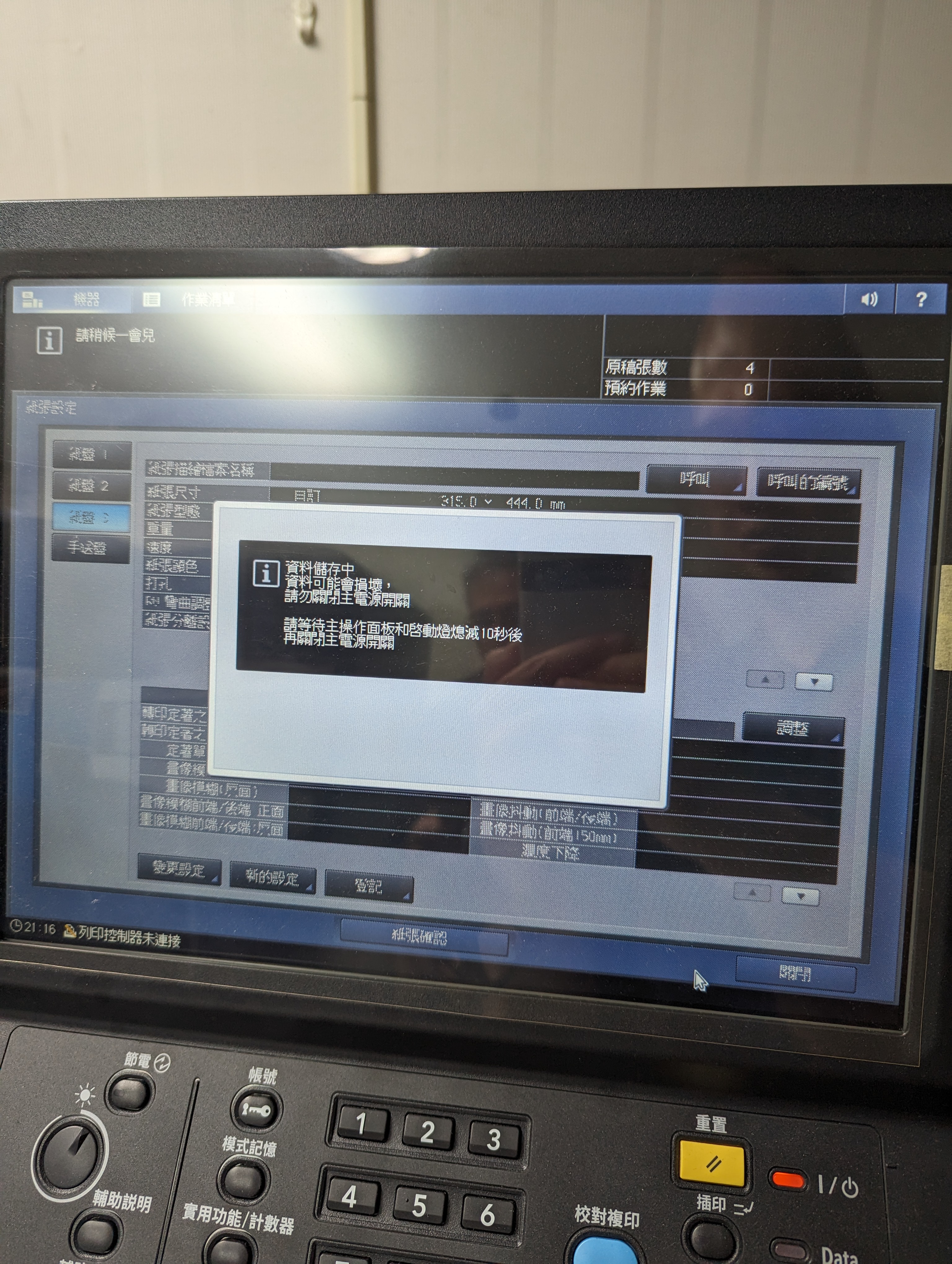

Our company (in Taiwan) recently purchased a Konica Minolta C14000 last month. Currently, we are in the process of trying out various types of paper, and only in the past one or two weeks have we started large-scale printing. However, last week, a colleague noticed that when shutting down the machine after turning off the auxiliary power, the screen displayed the following message in Chinese:
"Data storage in progress. Data may be damaged. Do not turn off the main power switch. Please wait for 10 seconds after the main control panel and startup light go off before turning off the main power switch."
Surprisingly, after seeing this message, we waited for over an hour, and the screen did not turn off. Eventually, we had to call the machine engineer. He explained that it was because we had printed a large number of files that day, and the machine was still saving, hence the delay. However, we typically print only a few dozen files a day, and such a long shutdown time seems excessive. Later, the manufacturer's sales representative told us that if we wait too long, it's okay to shut down directly. In the following days, the shutdown still took twenty minutes to over half an hour.

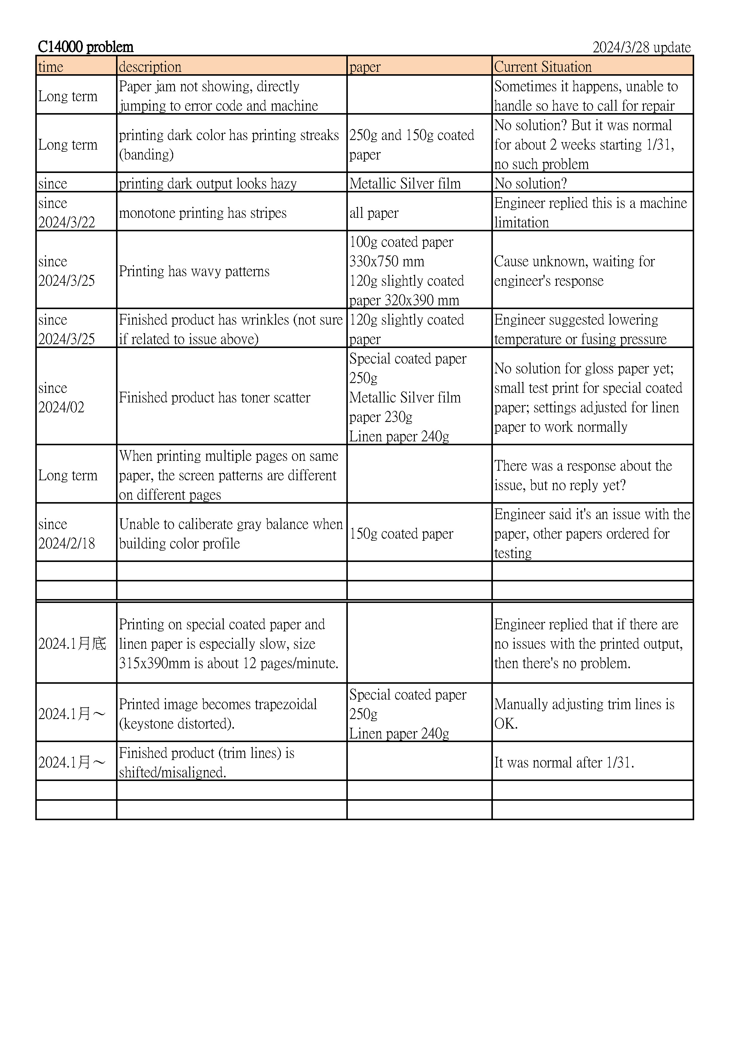

Thank you for your concern and sorry for the late reply! The issue has been resolved. However, our C14000 has accumulated quite a few problems over the past few mbelow) ... shown in the image below)... We are still discussing with engineers how to address these issues. Perhaps I should start a new topic regarding these problems...
