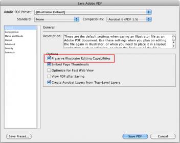

To follow up on what Wharfrat posted, check the following settings when you save in Illustrator. Is this option enabled? If so, this includes the data mentioned in the quote from Dov.
Greg
Interesting, but if I uncheck 'Preserve Illustrator Edit Capabilities' and save the pdf the Illustrator pdf remains at about the same size. Does Illustrator Illustrator include the native data whether this is checked or not? Thanks everyone, great explanations!

I did a quick test here, and a lot depends on the composition of the file. When I saved out a file containing vector and raster elements, turning off the Preserve Illustrator Editing Capabilities switch dropped the file size by ≈35-40%. A file containing only raster elements showed a little over a 70% reduction in file size. Each typeface added to the design diminished the difference in file sizes by a little.
Now, this is a very small file I'm playing with, so the percentage difference in file size is probably exaggerated.
