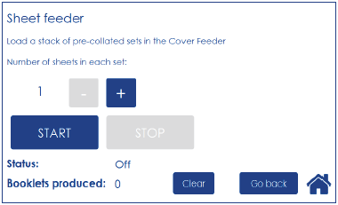

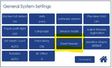

You don't have to manually feed sets into the machine. You run the precollated job from the top feeder. Set-up is in the control panel. You tell it how many sheets are in a set and it pulls that many sheets and binds them. Once you know how many sets fit in the feeder, you can break the job into lifts to speed things up.
Go to TOOLS (the little wrench and screwdriver symbol) from the main screen. That takes you to GENERAL SYSTEM SETTINGS > SHEET FEEDER
Set the sheet count, press start. It will count the books produced. Hit stop when you are done.

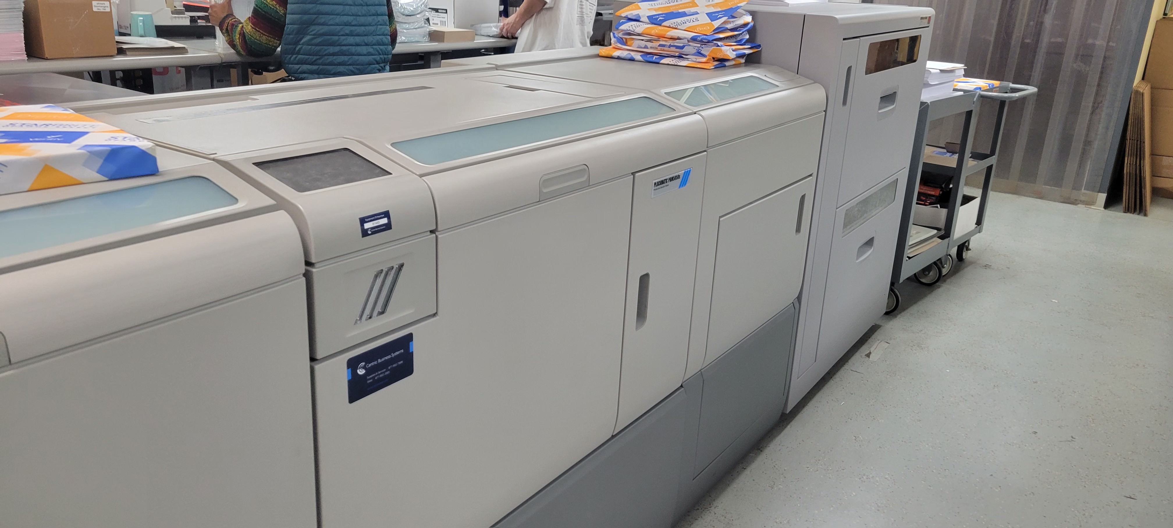

We have one, with the 2 feed drawers, we expressly bought it and had it configured for stand-alone use.

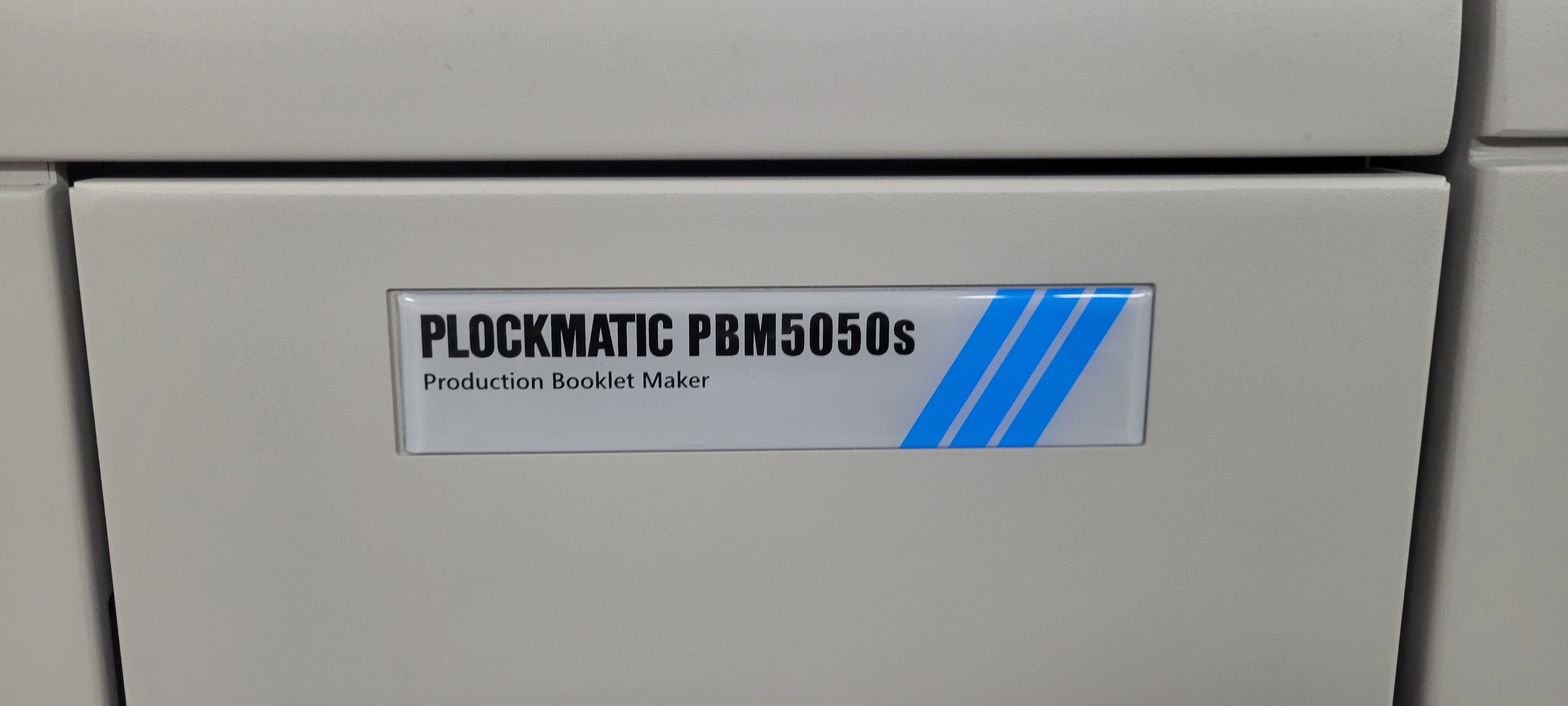

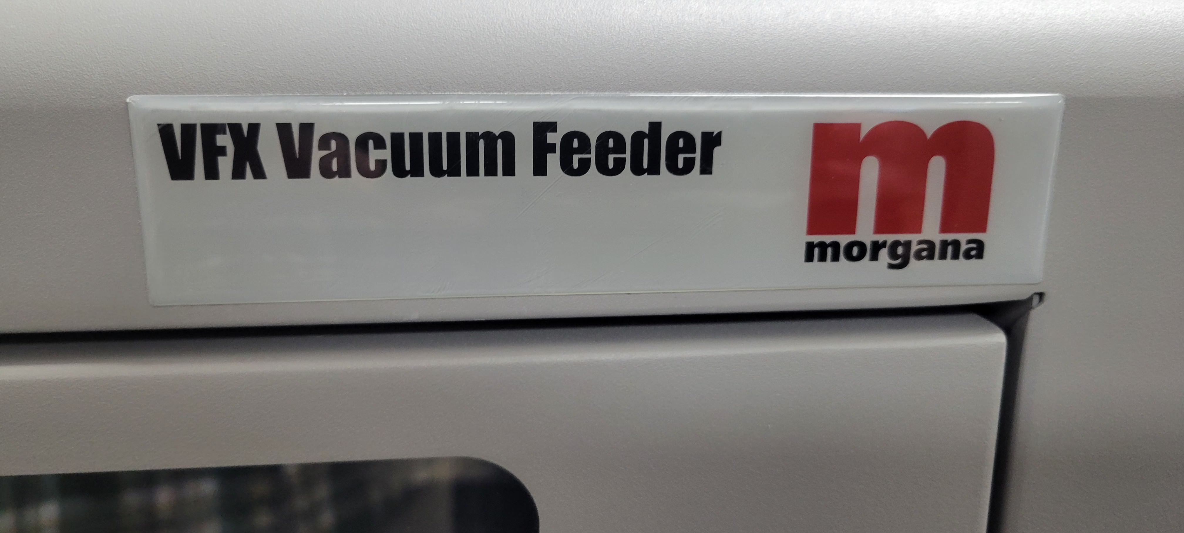

We bought is as stand-alone. And, I apologize it is a PBM (plock book maker) 5050. with Morgana VFX Vaccuum Feeder, which has 2 drawers.
It also has a square-edger
