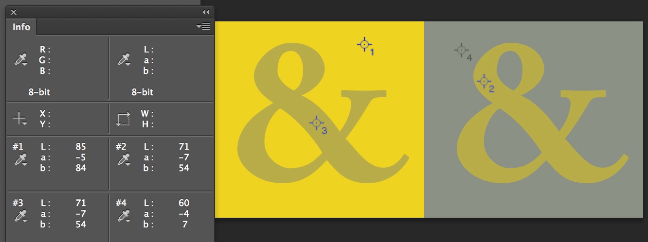

I remember a client who had a graphic similar to the below who wouldn't pay their bill because the two "&"s that had the same cmyk values were supposed to be the same color. They didn't appear that way so the assumption was that we screwed up.
Sigh.
Sigh.
Gordo, is this a case of good old simultaneous contrast?! Your sample above does not use just two discreet colours…
Sometimes to get the same two colours to visually appear to be the same, they need to be different and built from 4 discreet colour builds, not the same two!
You betcha! The sample uses just two colors (the &s are identical hues). Try talking simultaneous contrast to a graphic designer. Try using a spectro to help get recipes to match two colors that it sees and measures as being the same.
Let's see... these two colors look different but have the same Lab values. Hmmmm.
ROTFL
ROTFL
My mistake Gordo, I thought that the sample used four discreet colours, however closer inspection reveals three.
I thought that you meant that the designer would build using only two discreet colours, not understanding that they may need three or four discreet colours to visually match “the same colour”.
Stephen Marsh

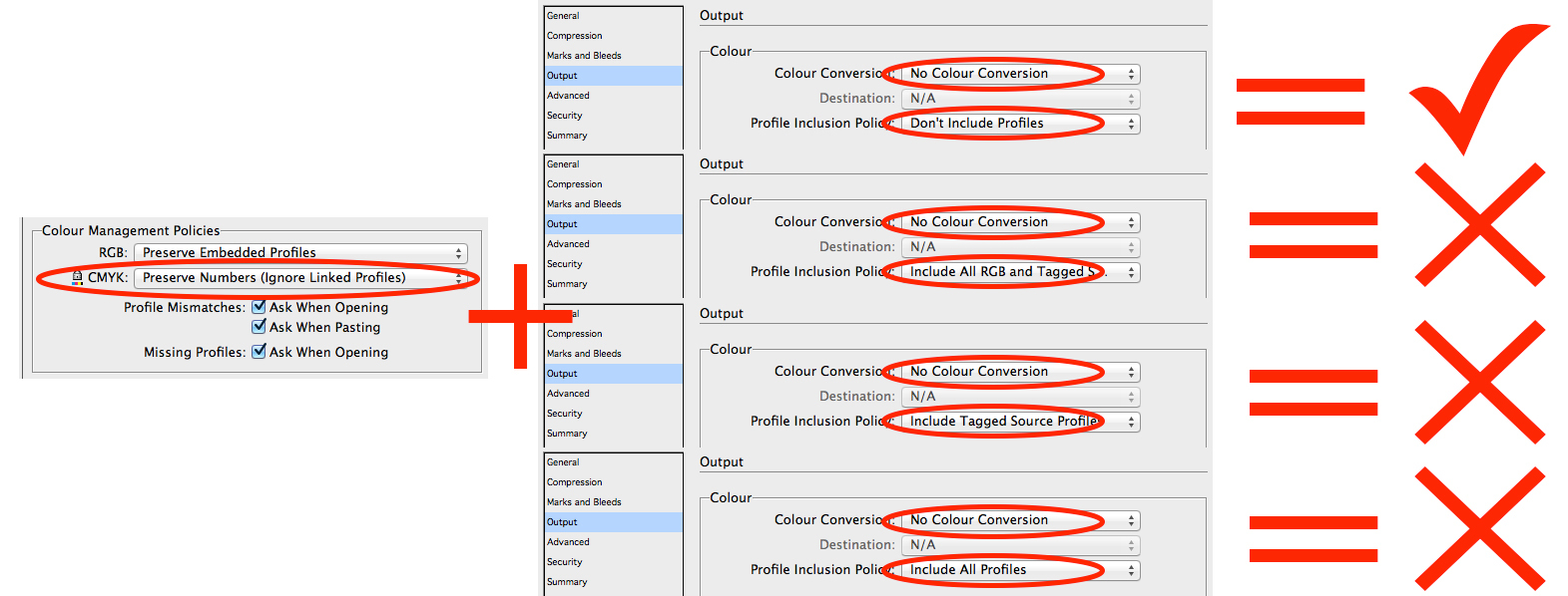

Magnus, I still wish to talk about “no colour conversion” in the PDF export resulting in “colour conversion”, depending on whether one includes or excludes ICC profiles (this is not a PDF/X4 export concern though)… If anybody is interested that is! Is it a bug, or just my misconception of how InDesign manages colour between colour management policies for honouring or ignoring profiles and the export settings?
Stephen Marsh

Perhaps if I showed an infographic to simplify my point (hint, X = incorrect, a CMYK colour conversion)…
Test .zip archive attached (.indd / .idml / .tif)
NOTE: If you open the IDML file rather than the CS6 file, ensure that the placed image has image colour settings set to use the embedded coated_FOGRA39_GCR_bas.icc profile, rather than the document profile of Coated FOGRA39 (ISO 12647-2:2004)
Is it a bug, or just my misconception of how InDesign manages colour between colour management policies for honouring or ignoring profiles and the export settings? I understand that the image profile is different to the document profile, which calls for a conversion – however the export settings are set to no conversion and colour settings call for safe CMYK workflow of ignoring profiles! So what gives? And why does exporting with no ICC profiles honour the CMYK values, when including ICC profiles converts the CMYK values?
