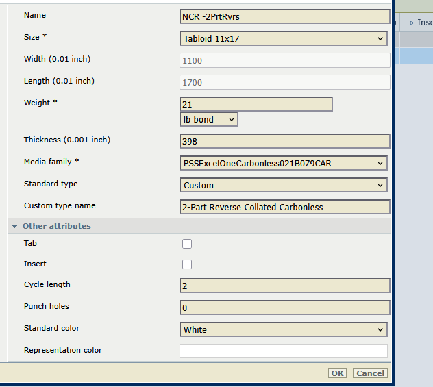

Anyone have some settings available to share for NCR? I have a media profile from Think.com before they cleared all their specialized profiles. But when I adjust the cycle length, it still doesnt pick up where is left off when I have a jam. My job is NON variable, 2part NCR. 2nd sheet differs from first sheet. It DOES show as mixed media when applied to my job.

hmm, well I mispoke it seems, changing my cycle count, (so knows my media is precollated) worked for this job. It DID spit out paper when I tested to resume correct sheet. My problem was with variable data, like consecutively numbered receipts and such. I will repost when I get to another variable and i DID write down what you said, I used to have to do that for Fiery...I completely forgot. Thanks!!
I've never gotten variable data to work with the cycle count on any of my Oce/Canon devices. I have a separate media I call "NCR_2Part-2", that purposely has the cycle count set to '1' and we have to manually fix the next sheet in the tray based on the last sheet out of the machine during a jam.

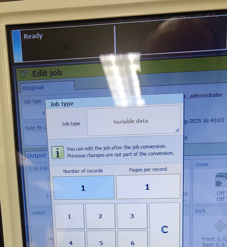

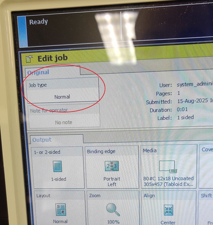

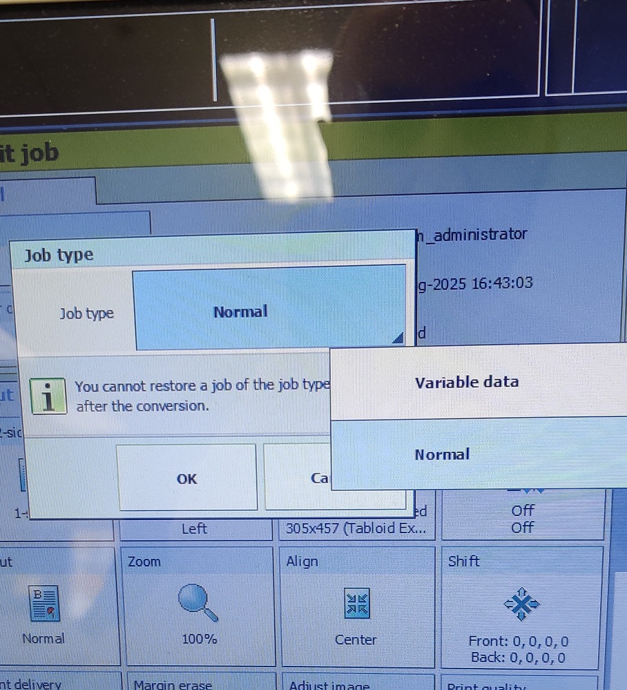

Not sure what the Prisma Controller looks like on the iX, but on the Canon we have you can set up variable data and page counts per set. I've honestly never used it, but it should make cyclic media work properly.
