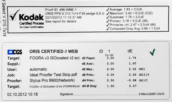

This is a standard feature of many proofing systems that provide "certified proofs".
Using a spectro to calibrate is one thing. Using a spectro to verify that the proof printed passes an industry specification is another. Without the label nobody would know what the conditions were when the proof was measured. Even when a system is calibrated a proof may fail certification for various reasons.
We are distributors for CGS ORIS Colour Tuner // Web and Kodak Matchprint Inkjet systems. Both use labels to show the dE tolerances for key colours of the proof (substrate, primary, neutrals, secondary overprints etc). If one is using an inline spectro, then the label is printed directly on the proof. If one is using an offline spectro, then one requires a Dymo labelwriter for the stickers. One has the option to have a single colour bar/label for the entire nested sheet if printing multiple jobs, or one can have a separate colour bar/label for every job on the sheet.
I am sure that GMG, EFI and the other main players offer the same features. This would likely be a license upgrade feature if you don't currently have it.
I'll post a couple of images from CGS and Kodak proofs for your reference.
EDIT: Sample Kodak & CGS proof label samples (printed inline on the 9900 proof, not using a separate label printer).

You need GMG proof control module which will then measure and print the certification info inline, no need to print out separate label.

Some shops run them once per scattered/nested proof form or impo (one colour bar/media wedge and one certification label). Some shops run them once per scattered/nested job on the form (multiple colour bars/media wedges and multiple certification labels). Some shops run them once at the start of the day and after lunch as in internal process control measure. It depends on the shop, the shop's customers, proofing accuracy requirements etc.
G7 I believe is one thing (method, a means to an end) - will you be printing to GRACoL, SWOP, Fogra 39 or some other specification (target print condition, usually an industry spec. or a house spec.)? Depending on the proofing system, custom house press conditions could also be have certification labels applied.
