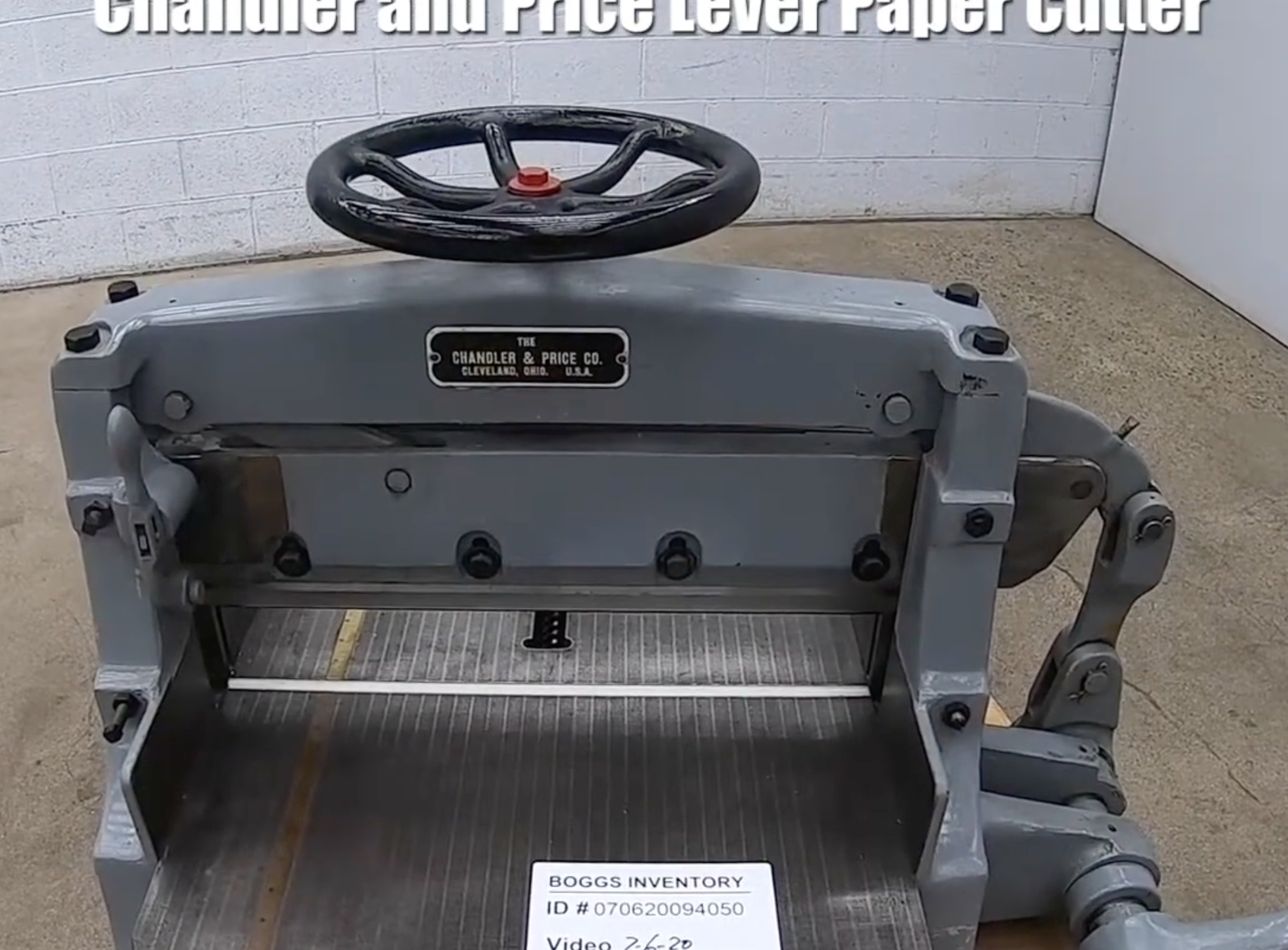

Is it something like this one? Maybe figure out a bigger wheel for more leverage?
This one in the video seemed pretty easy both ways. I don't have one but I have looked at a few thinking about it just for a back up.

Very Close, It has some engraving on the front and a much bigger wheel above it. I am using a clamp pad that I may remove and have less pressure distance.
