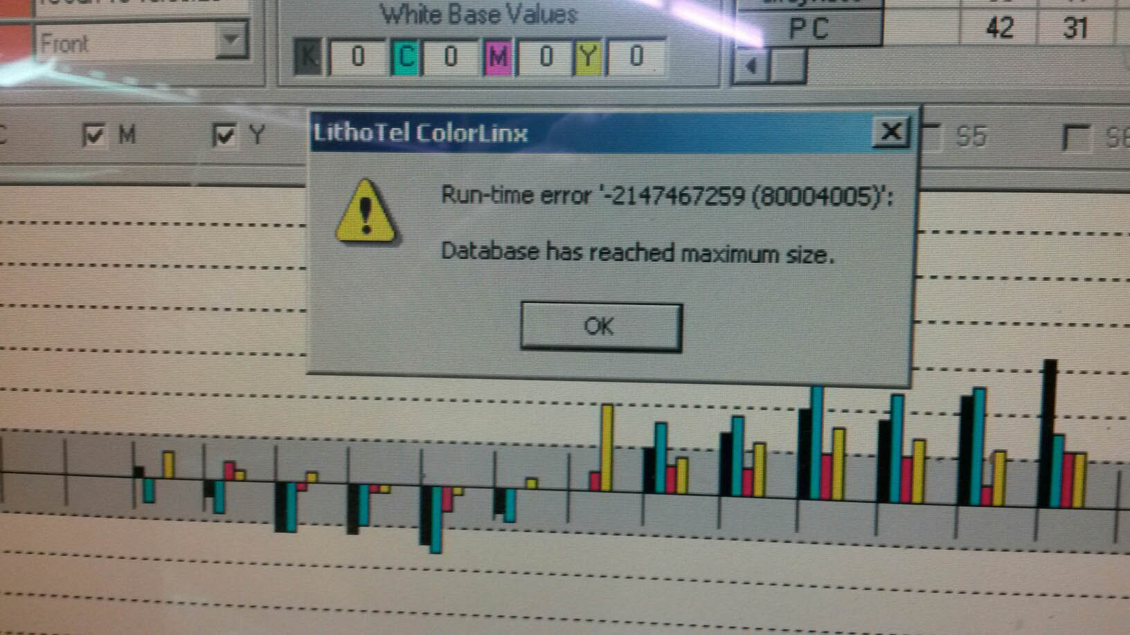

Do any of you guys use LithoTel Closed Loop software on your presses? We have been using it since 2000 and it's worked great. But the software is starting to act flakey and I was going to try to reload it and found out LithoTel closed shop! So I have no one to help me reload the software which makes me a bit nervous.

We get a "Database" full error when trying to apply a scan. Couldn't find a way to clear the database, other than manually going 1 job at a time and deleting out of the database list. But we even did that and deleted about 20 jobs manually and we still get the database error.

It's standalone. Have done the usuals: Reboot. Defrag. On a Windows 2000 box. Everything is saved to that box. The problem is I don't think it will load on anything except Windows 2000. This system was purchased back in 1999. I think all the scans are saved automatically. I tried to go into the database and remove old jobs but I couldn't find a way to remove all. Had to go 1 at a time. And even after removing a ton manually one at a time we still get the error.
I told a pic of the error. Here it is.

I recommend you try the easy fix first, download CCleaner (free) and clean up your temp files and cache.
If the above doesnt fix the problem then you free up some space in the Access database, try compressing the unused space.
1) Open the Access database
2) Under Tools > Database utilities > click "Compact and Repair"
3) Delete any 'old' data which can be archived off into off-line storage, then compact the database to reclaim space from the deleted data
let me know how you get on
Hey maas. thanks for the ideas! tried the CCleaner with no luck. Now, I don't appear to have Access on this computer? But I did stumble upon a ColorLinx Maintenance Manager. Tried to launch it but it then asked for a password which I have no idea what it is...
Ok, from this i am more sure that your database is simply full, the only way to adress this is to gain access and delete historic files and for this you will need to log in as an administrator.
I am not a tech so before you start deleting etc copy the database as a backup better yet consult an expert (IT support)

We use Lithotel and yes they are out of business. The default password is "colorlinx" and is not case dependent however the database is Microsoft Access 97 file format. You will need Access 97 to open the DB. The database name is ColorLinx 72.mdb and resides in the program files Lithotel folder. My database does not have a password. If you restore or to a clean install you will loose all of your colour bar data, curves, jobs and plate definitions. It is likely that your total DB including the Jobs table has reached the 1GB limit. If you can get a copy of Access 97 loaded onto the machine your best bet would be to open the DB, open the JOB table, delete old jobs, close the job table, select Tools-Database Utilities-Compact and Repair Database, and save. Access is not a difficult program to operate but make a copy before you start just in case you accidentally make a mistake.
