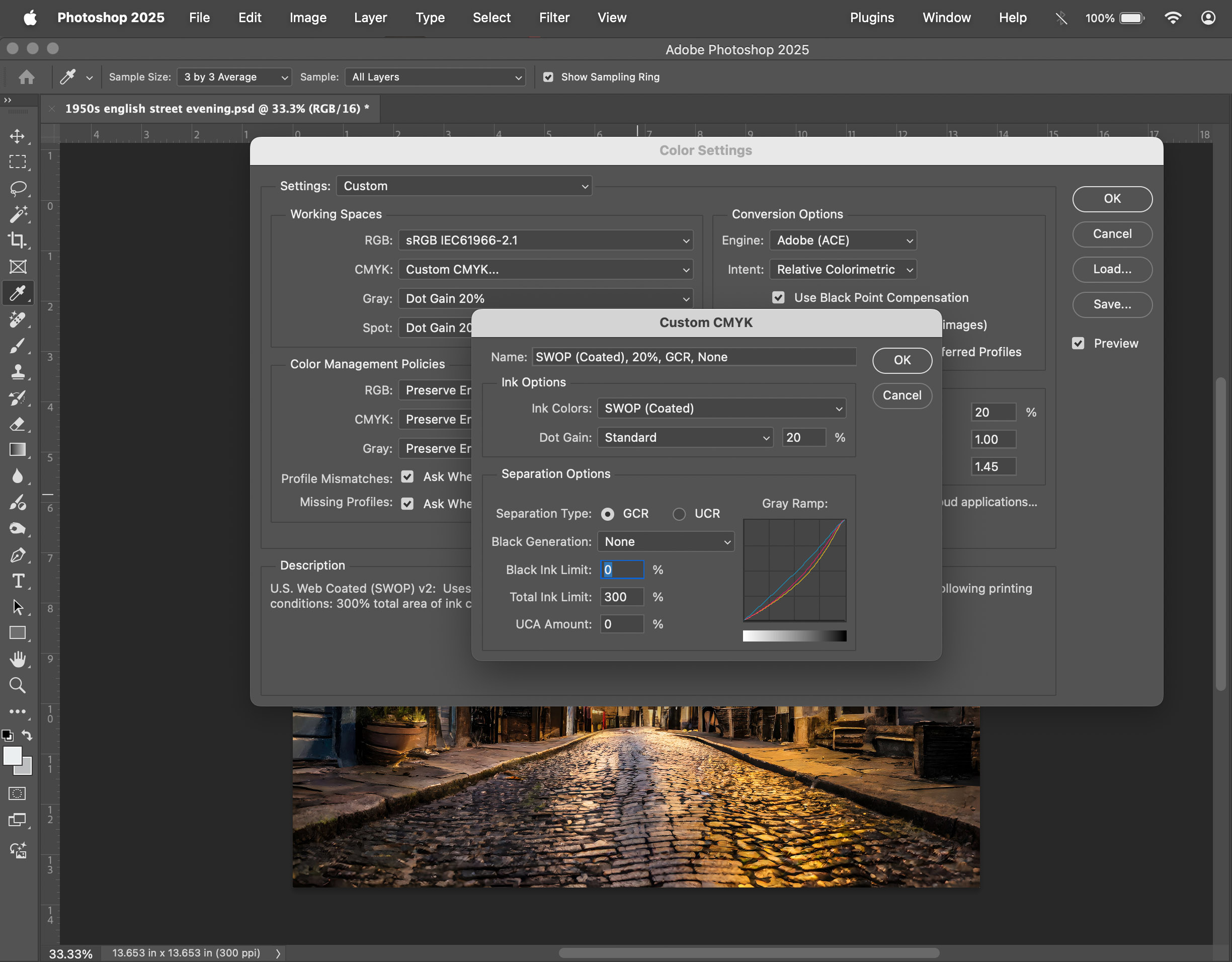

To convert CMYK to CMY can be easily done by comverting the CMYK image into RGB and reseparating the new RGB image into CMY by changing your color settings to Custom/no Black.
Converting from CMYK to MYK - Convert the CMYK image into RGB. Then create a new blank CMYK image at the same size/resolution. Then go to the RGB image and copy the Blue Channel and then paste that into the Yellow channel of the blank CMYK image. Then go back to the RGB version and copy the Red channel and paste that into the Magenta channel of the CMYK image. Then go back to the RGB image and copy the Green channel and then paste that into the Black channel of the formally blank CMYK image. Select the M & Y channels and make tone/ contrast adjustments to the M & Y together to achieve the look you want. The below sample looks bad because it's the CMYK image converted to RGB by the internets.
