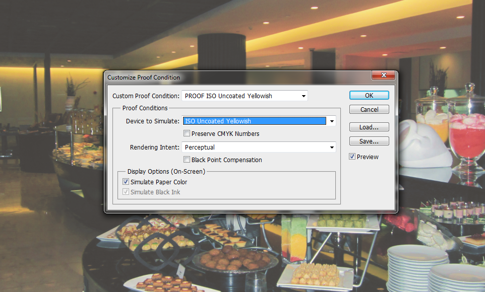

On screen I can simulate this with using the proof colors > custom feature with the option "simulate paper color" on.
But I want to save this color information and save it again as an image with our standard ISO Coated v2 ICC profile.

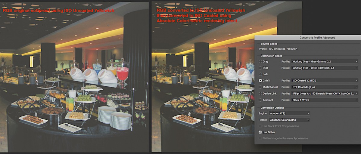

If I understand correctly, you will need to convert the CMYK image tagged with the Uncoated Yellowish ICC to ISO Coated ICC using absolute colorimetric rendering intent (if this is “too strongly yellow”, then you should knock together an action to combine the steps used to create the less yellow version).
Stephen Marsh

As Stephen implies, if you want to simulate the result of printing on the yellowish stock you need to convert the RGB image to the profile of that printing condition first. You can then print that profile using the Absolute Colorimetric Rendering Intent to the designated output device (printer) as long as you have an accurate profile of that device to target and the colour space of that device has a larger gamut than the source profile. This is the essence of proofing.
