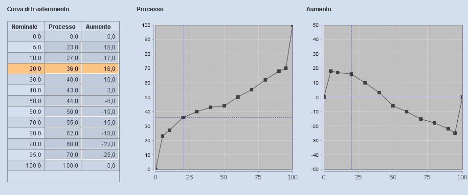

you say, there aren't any solution to set curves in cpc 1.02? in PPI if i do some settings to transfer curves there are some changement in ink keys cpc 1.02, but if i set the curves when i go in cpc 1.02 there aren't changement in ink keys. The only solution i find is set transfer curves (like image), it's normal that carachteristic curves not do changement in ink keys?

The problem is with my SM102 with cpc 1.02 with job card. how i do to set curves? the only mode i found is to set transfer curves in PPI, but the problem is that the aperture of yellow is not the same of black, cyan or magenta, if you see the image that i post the transfer curves are very very changed. The consolle was inizialized when it's maked, but this setting isn't good for me, there is some mode to set new curves in my consolle?

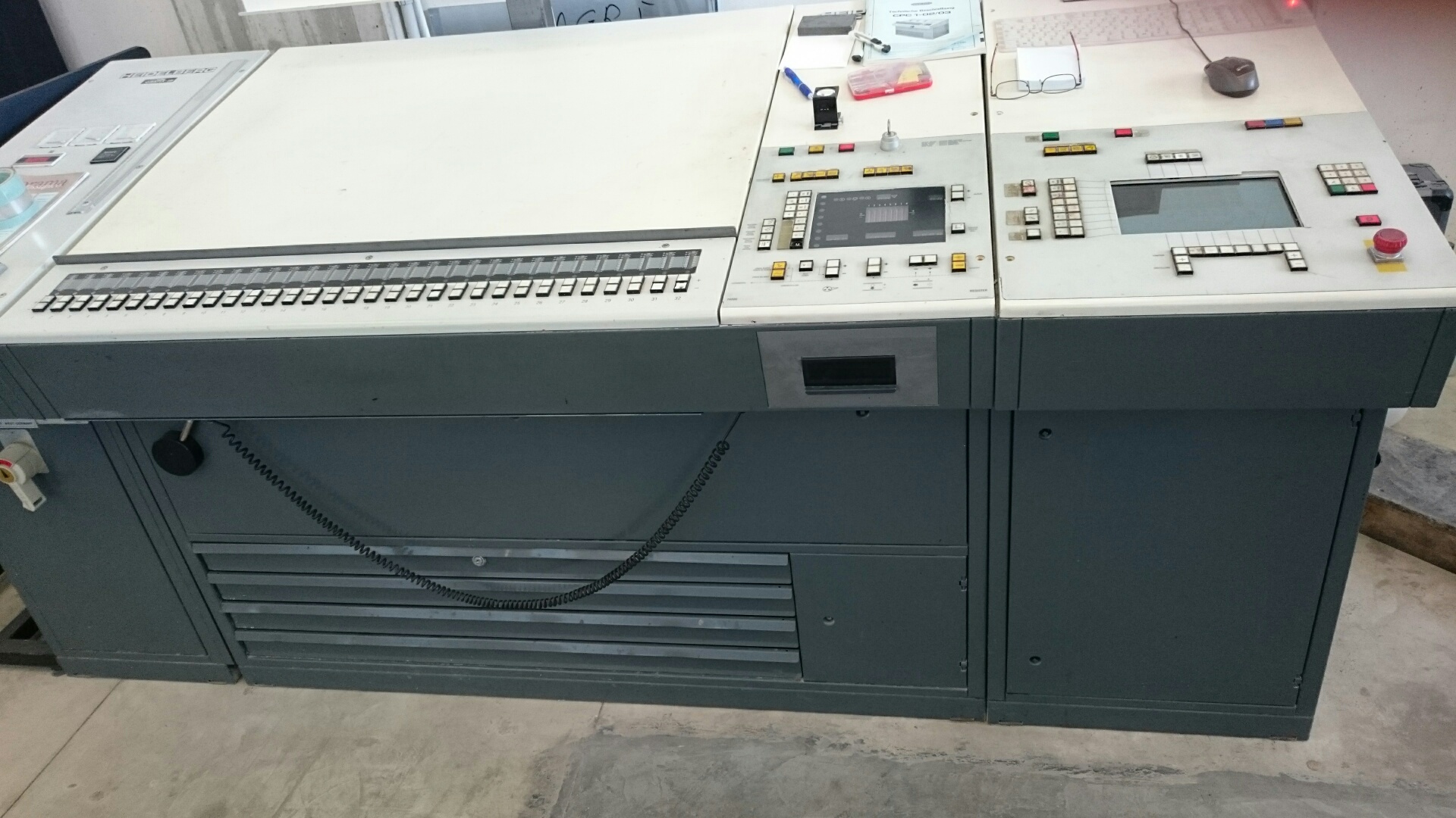

Sorry Mark, I do not think that it is possible to modify a curve in the CPC 1.02 because the technology is not there. You have to take the basic data that the PPI sends to the flash card and make adjustments manually on the press. Could you please send a photo of the CPC console that you have on your current press? I am need to see something that might help assist you

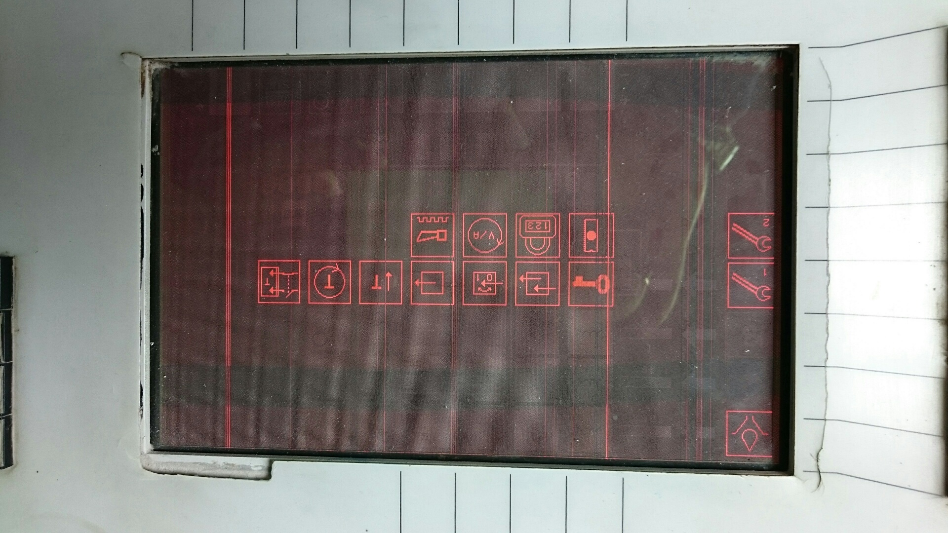

Mark, I don't know if you have the right software in your CP TRonic (the Console attached to your CPC 1.02). I may be wrong but if you want to try something it might work. Select the Service Button (Wrench) on the CP tronic and see if there are sub menus for service. You might see a menu for Curves that will look the same as you have on your SM52 with CPC 1.04. If the menu is there then I think that you might be able to create curves. When you create the curves that you want then you should be able to apply them to the data from the PPI.
The CPC 1.04 console was a more simple way to connect the CPC 1.02 and the CP Tronic into one unit.

the photo attached is menu service i can see!
here are many menu activable with some tecnic?

Your press does not have the option to create characteristic curves from CP Tronics, otherwise you see a curves Icon just below the lubrication icon. See the attached file.
ok ! thanks a lot for your interesting! i know there aren't any solutions to set carachteristic curves! only solution is to buy a INK ZONE product or other similar system controll ink , image controll, or other solution more expansive to buy for this machine. Before to connect some system controll ink keys i must install board BEK.
