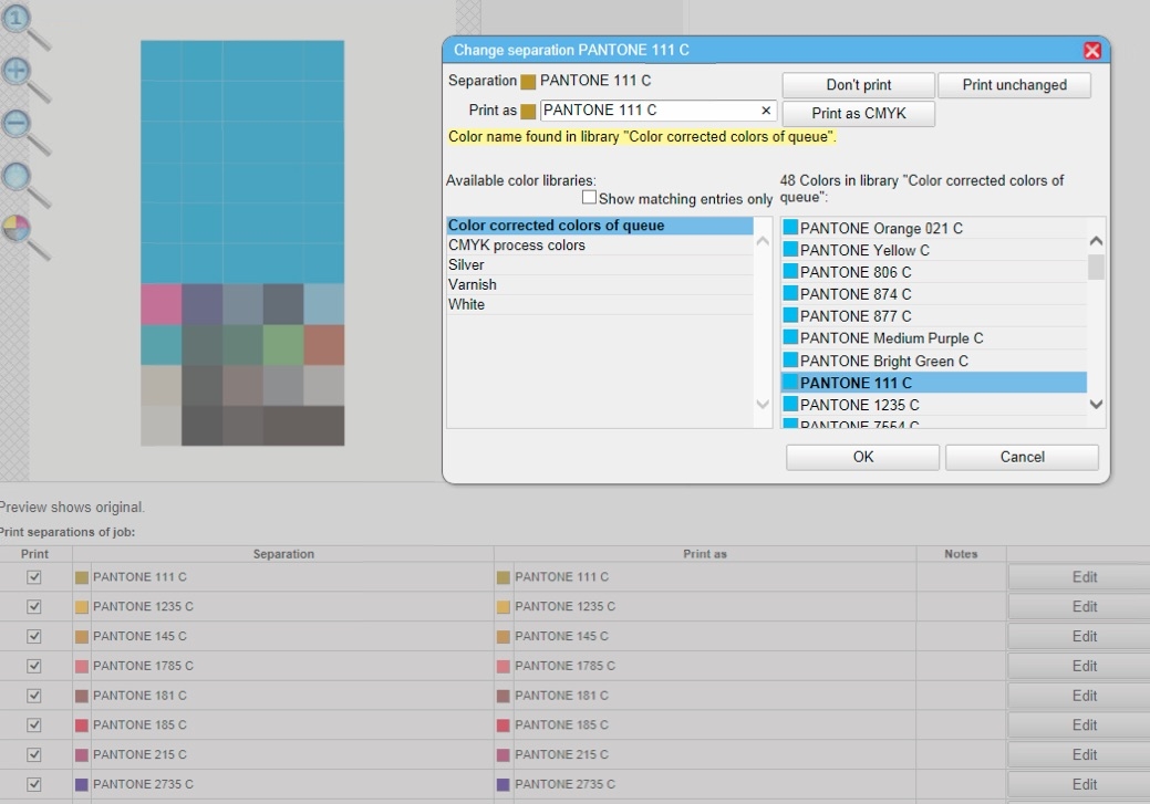

I just tried with the latest version of CGS ORIS Color Tuner // Web using the APPE engine.
Now as the source was setup as Lab spots, this may not be a problem! So if you know that your RIP/DFE can correctly render from a Lab based spot to final device space, then you are all good to go. Otherwise you may have to convert the spots to final proofing device CMYK (not press simulation CMYK) first and run the chart with no colour management.
