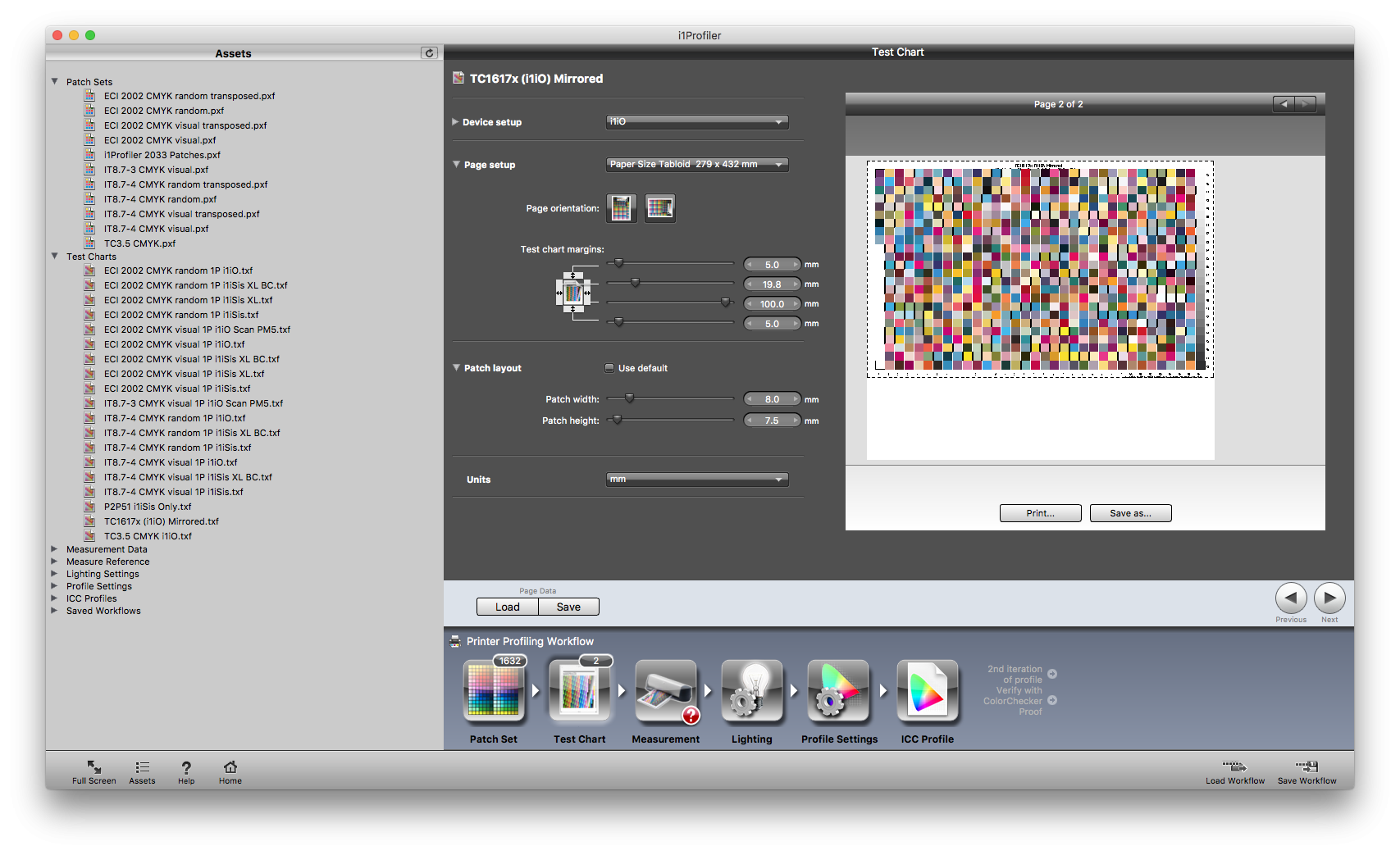

Looking for help with i1iO to read the TC1617 (IT8-7.5) chart but in reverse.
Printing flexo wide web, surface and reverse print and I would like to make a curve and profile for both types of printing (but only make surface plates), except we can't fool the i1iO to read the chart in reverse. I'm trying to avoid making 2 sets of plates if possible.
We are just testing it by printing a chart and reading it in reverse as if we used the surface print plates but printed reverse.... confused yet?
Is there anyway to fool the xrite or the txt file when we load it in to i1Profiler 1.8.3 so that when the chart loads up it will be in reverse, just like the sample. When it reads, the squares are the wrong colour, when they should be the same colour but a few shades off.
I've tried reversing the triangulation when it asks you to pick the corners but that doesn't work either.
Any help would be appreciated!
I don't have an IO to test this, but it looks right in I1Profiler.

I saved it out of the profiling workflow. you should be able to import it and measure from there. I really hate how the file formats are so convoluted in i1Profiler. Let me see if I can figure out the black magic to get it from one area to the other.

I'm on OSX. In the Printer Profiling Workflow, you should be able to drag the .txf file onto the Test Chart icon at the bottom and go from there.

Try this. You need a measurement to save a rmxf which you can then import and save as a rwxf. How convenient.
