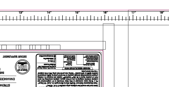

Hi guys,
Is one might be a tricky one. Can a crop to visible objects be done? Please see the attached screen captures. Ones in color mode, the other in line mode. It's a complicated Esko PackEdge Markset that has a sliding white box to the right that I always have to then open in Photoshop and crop down when the 1-bit tiff is made to get rid of the dead space.
Callas pdfToolbox can do that (and many more). I tried it in the most recent version, but the fixup (Crop to Visible Based on Rendered Image) is available since version 10. Please see your example fixed.

Yes it can be done in PitStop, but not with the PitStop implementation currently in AE. I'll check with the AE Product Manager, but next release I assume it will be included.

Thanks. We are currently only on AE 16.1. Oh well.
