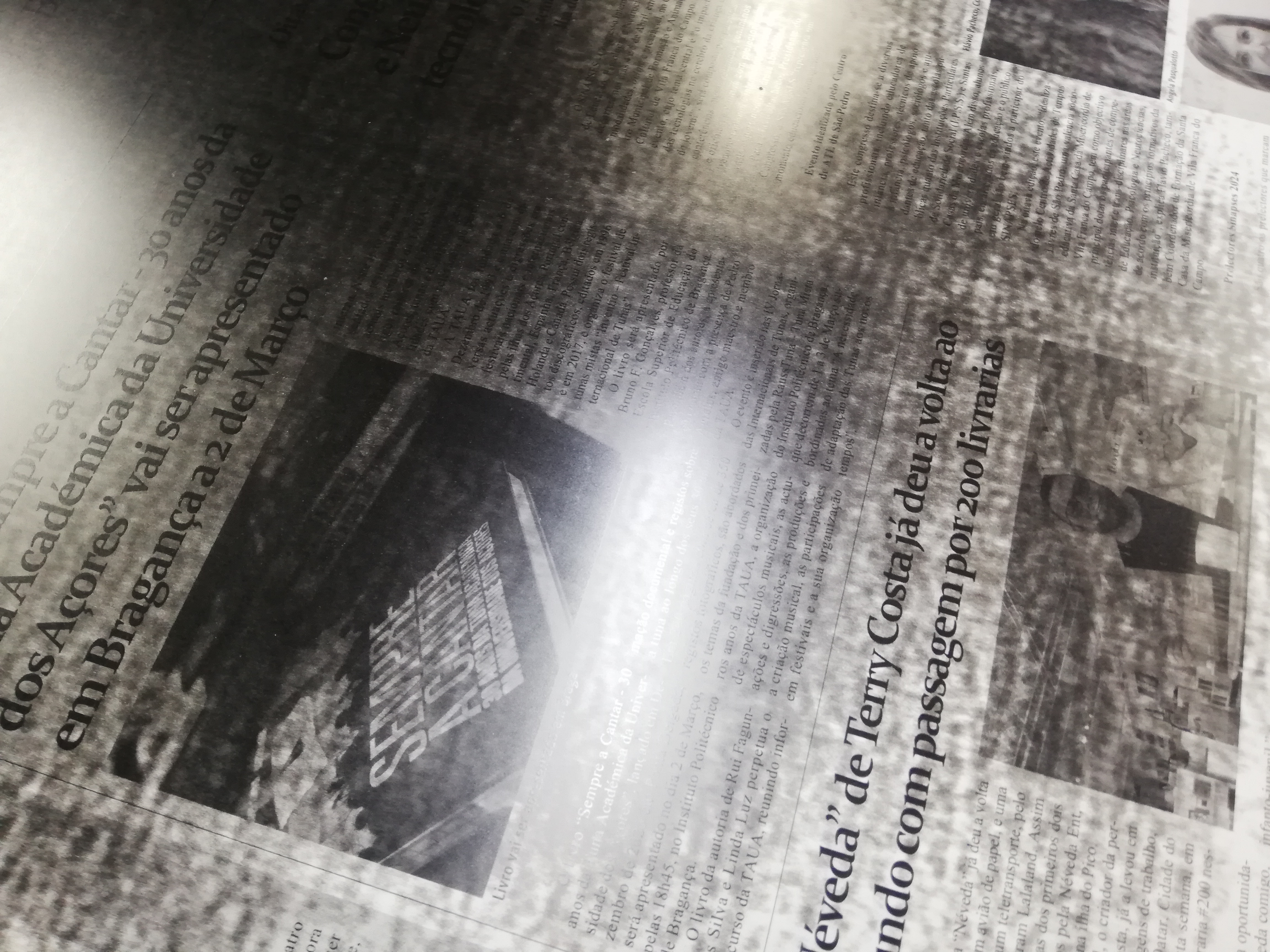

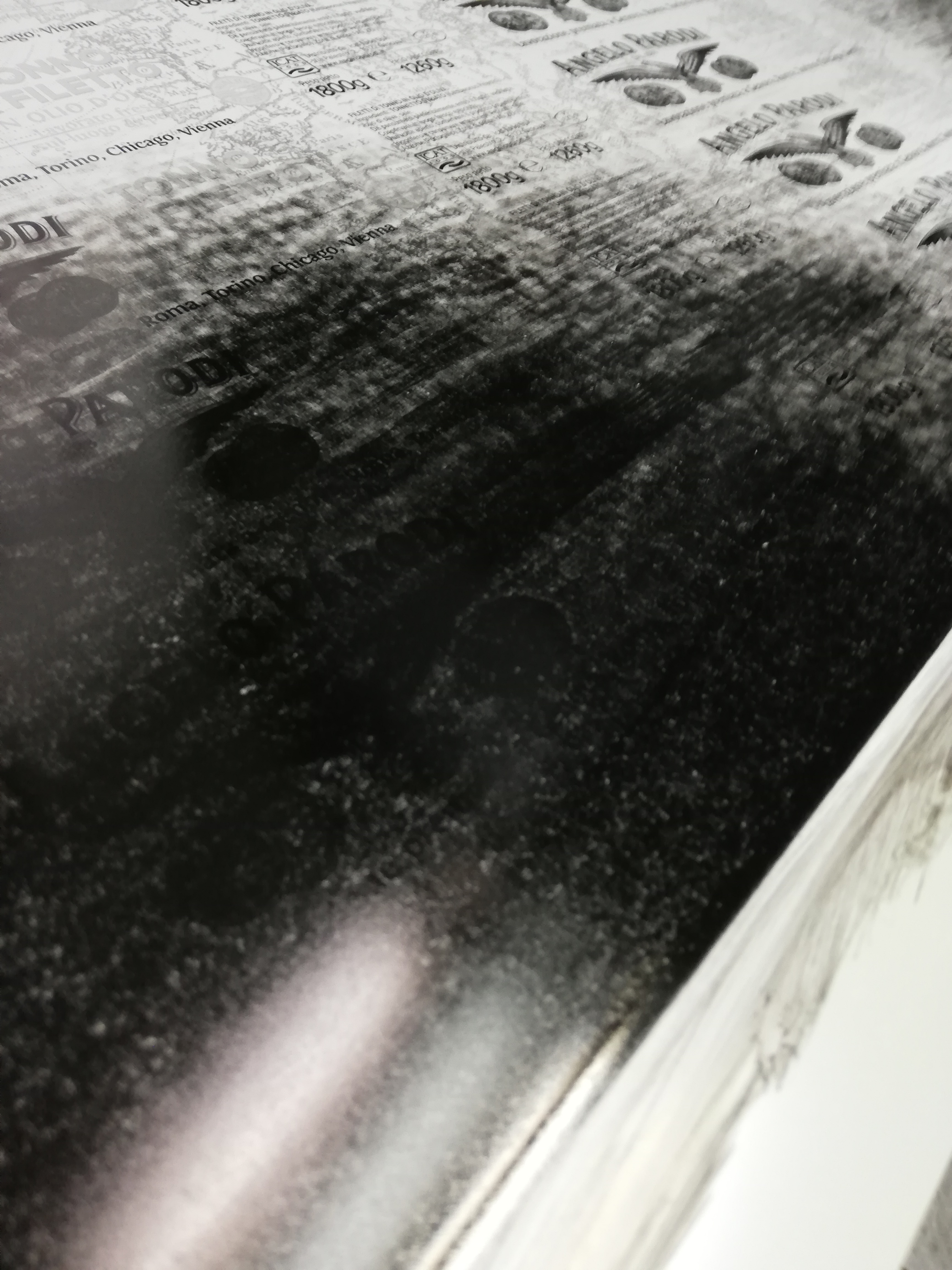

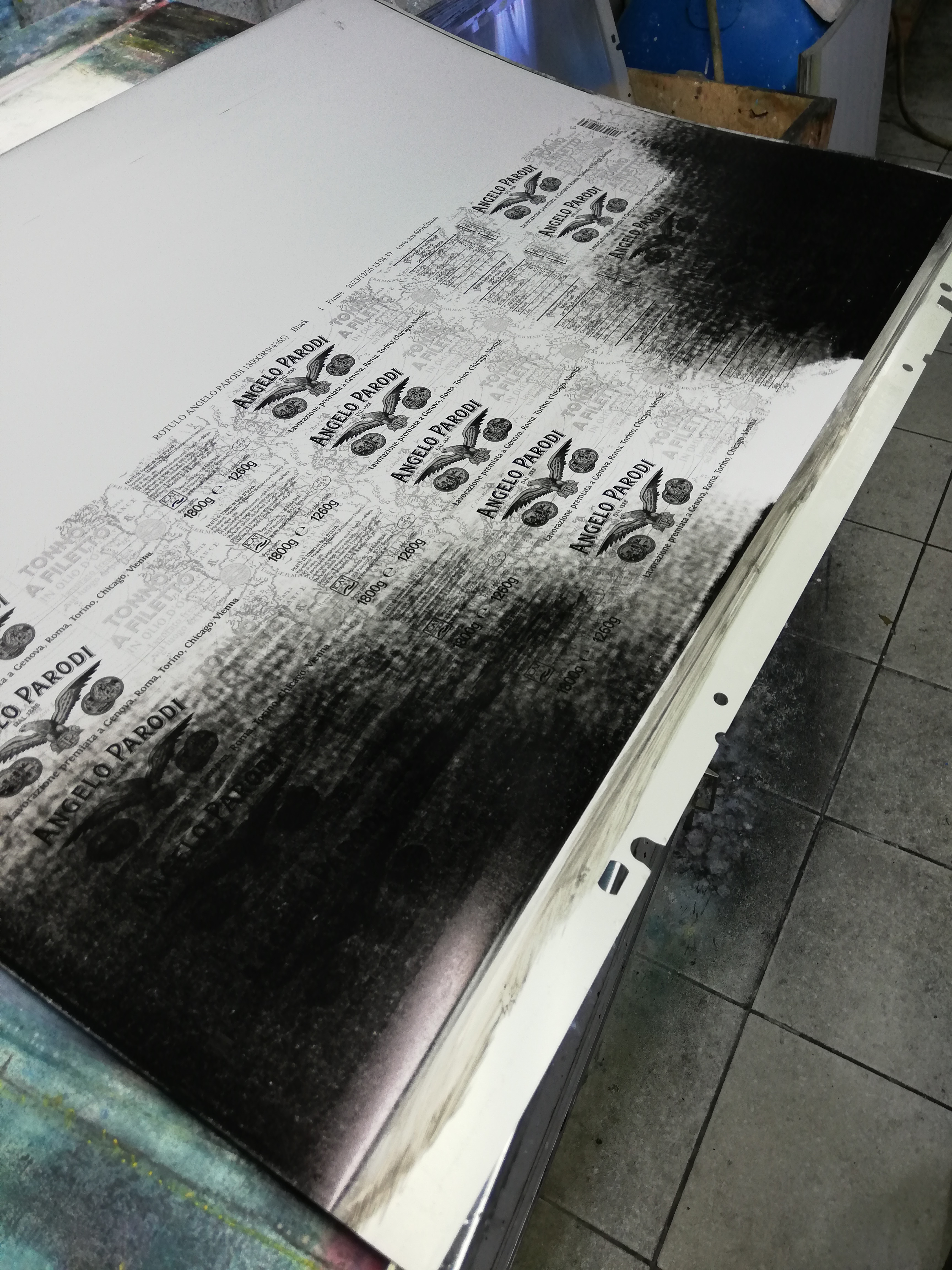

hello, we are in the print shop using CTP Screen PLATERITE PT-R4300 E (THERMAL) and ECO3 plates and some when put in the Sakurai printing machine are getting stained as shown in the photo! Does anyone know why? Some are ok, others are not! Thank you

I use ECO 3 Eclipse Thermal on a CTP Screen PLATERITE PT-R4300 E! reveals perfectly but when placed in the printing machines it looks like this (foto). We have been using it for about 3 months and it is only now that it has started to show these defects.

How far into the press run does this toning appear? If immediately, it might be a plate problem (I am hard pressed to believe it is a problem with the platesetter) but if later in the run, it could be press friction causing the non-image areas to start toning.
Craveiro, toning on large areas on DOP plates points to either underexposure on incorrect cleaning sequence on press. Your Eco3 supplier should have instructed your pressmen regarding coating removal. First thing clean you ctp optics, recalibrate and retest. If result is better but not perfect, increase the laser exposure in media type setting.
The Eclipse plates are negative working, their standard sensitivity of 120-130 mJ/sqcm will decrease if stored in cold environment or stored for more than 12-16 months. Check the expiry date on the label. Allow plates to acclimatize in the ctp room properly for at least one full day prior to exposure.

Our plates provider did mention something regarding underexposure, he should be here in a month or so, and we'll remind him to double check, just to make sure - Would you happen to have your values, at hand by chance? Oddly enough this problem persist, mostly, on yellow and black plates (CMYK Engraved)
I agree with @maxon. If the problem were due to underexposure, you would be seeing the issue shown in the video in all non-image areas and not just on certain parts of the plate. Roller problem?
Update: Turns out the problem were the plates all along - we got a new batch yesterday, tested them out and they came out, perfectly clean with some adjustments.

Turns out plates were very sensitive to light, we fixed it by using carry boxes for the plates - simple yet very effective solution.
