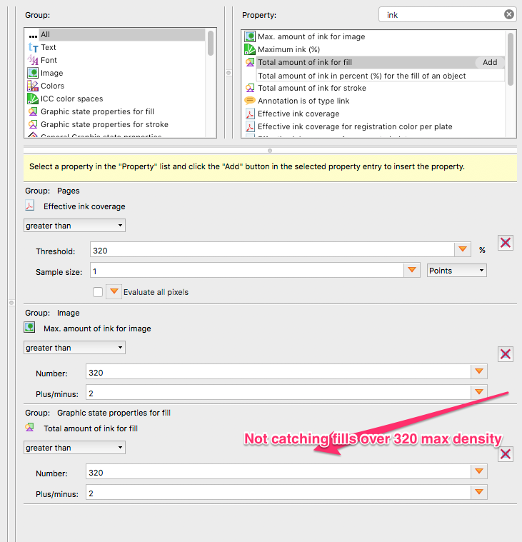

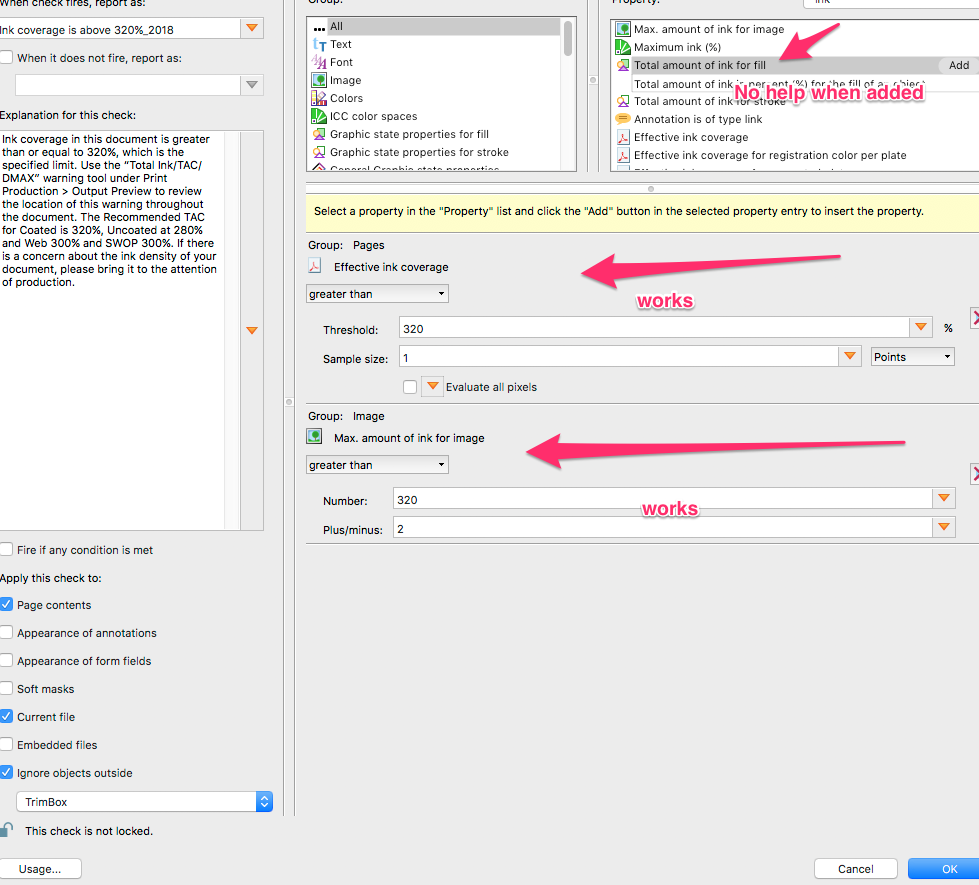

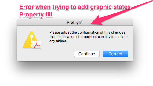

Custom Preflight Profile not catching Vector Ink Density Checks?
amybest222
Custom preflight profile, and Preflight profile only catches Images with Ink Density images, not Vector fills/ or strokes from Indesign or Illustrator. Obviously I want the ink density to be flagged in any state. Attached is also the file that I have been testing with and the preflght profile
