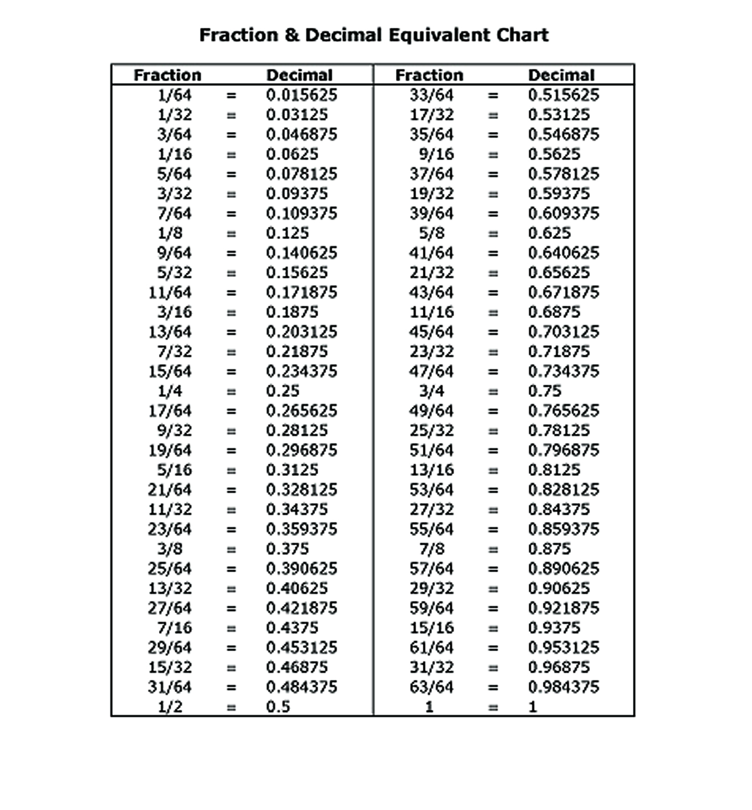

is this what you are looking for.
Thanks for all the info guys. Keith, I was thinking the same thing you were, and since we bought it used I wasn't sure. I called the guy we bought it from and sure enough, the plate had fallen off and he sent it over. So I have all the conversions now. Thanks for the chart maac, i think its a little more detailed than the one we have.
