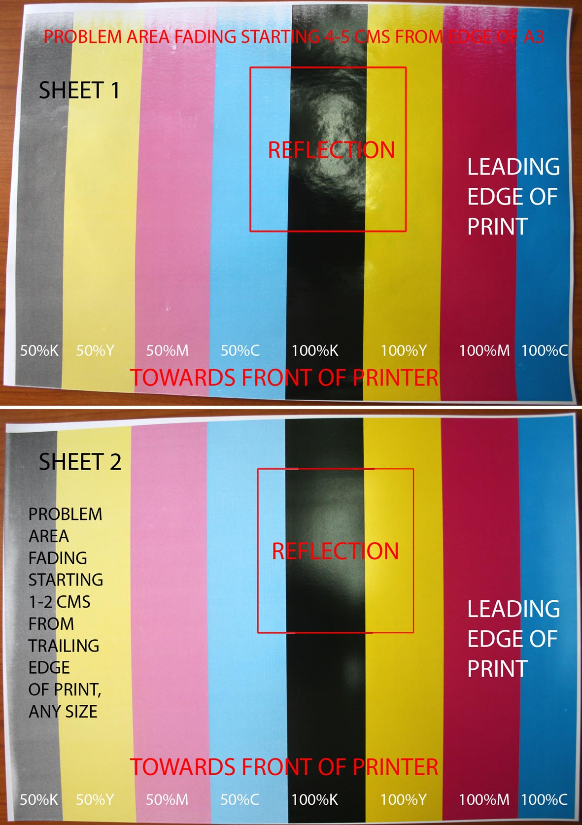

We have a big image quality problem on my Docucolor 2060 that has just started and my local technician (am based in Uganda) is seemingly at a loss, so I am looking for anything that can help us and him to sort out this issue.
I've attached an image to show what's happening. Basically we are getting a fade that starts 4-5 cms from the edge of an A3 (11x17") or an A4 sent LEF on the edge that goes towards the back of the printer so that if we print A4 SEF the image is fine because it doesn't reach the problem area. It is not happening in the fuser because if I force a jam I can see the sheets on the transport belt before the fuser have the problem already. It also does not happen on all sheets, for instance the bottom sheet in the attached image is art gloss 250gsm and here this problem does not occur (there is another less serious problem I will describe later). All other types of paper I have tried in the machine has the above mentioned problem, the sheet on the top of the attached image is art gloss 90gsm but it also happens with art matt (our most used type of paper) and bond. The problem generally seems to be more pronounced with art matt paper/board.
The paper on the bottom of the attached image is art gloss 250 gsm board and it has a smaller fade on the trailing edge. We have had this problem all the time but it has almost only been on art matt and we have overcome it by printing on bigger sheets such as SRA3 and making a big enough bleed to go beyond the fade. Now it's also appearing on gloss and is apparently getting bigger.
Especially the first problem is seriously hampering us because it means that we can basically only do A4s.
If any of you are familiar with this I would be extremely grateful for any hints/tips/solutions that will help us to overcome this.:)

Image 2 - I've seen this happen on sheets that have a lot of curl, either that area being a bit curly before being printed on or are being auto-duplexed where curl occurs after the first side is imaged. It was caused by the back of the sheet not making good contact with 2060's image transfer belt which causes the toner to not lay down on it correctly, which in turn causes a lack of image in that area of the sheet. For me it was more pronounced on cover weight papers because of their extra stiffness when curled. Text weight papers rarely had the same issue. I'm no technician so I don't know all the correct lingo, but that's what caused it here. You can check it by using a cheater and forcing the machine to stop when the sheet is under the image transfer belt. By looking at the belt you can check to make sure all of the toner is being laid onto the sheet, and what is being left on the belt. Your technician should be able to do this. Does grain direction change the issue?
I also found that I lost some image due to the area in the cutter clamp when cutting sheets from parents. Some papers looked like Image 1 in this case, but it was sort of hit and miss. Again, it could be curl related, so changing the grain direction might generate different results. I'm not sure.
Unfortunately in either case I don't know of a solution, but hopefully this info will help in some way.
Good luck.
Thanks Doubting Thomas. After advice my technician had a look at the 2nd BTR roller assy yesterday, he cleaned contacts etc. and the image quality is almost there, the fading has gone on the edges and remaining are just some small spots of white, not very apparent on my photo but there is one you can see on the top image above where it says "50%M", another on the bottom image above where it say "100%C" almost on the right edge.
