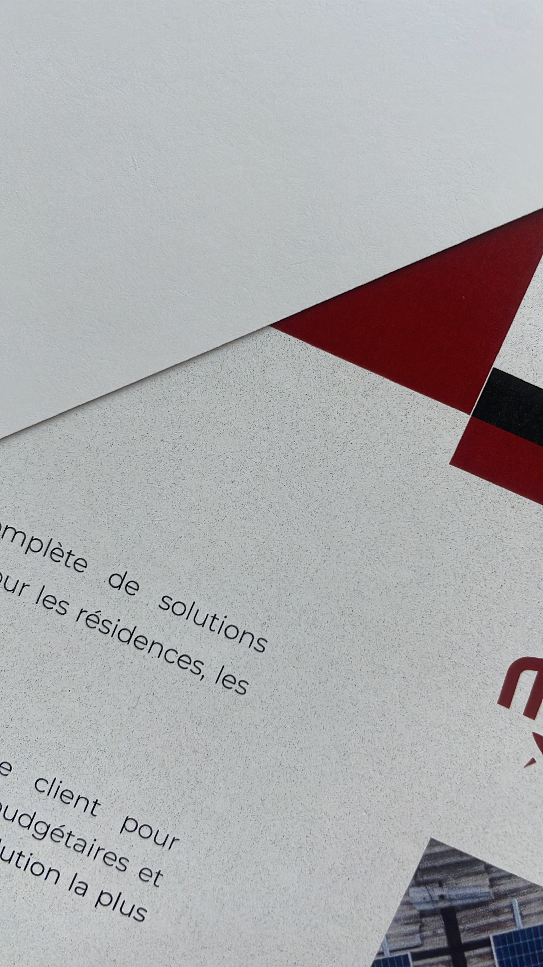

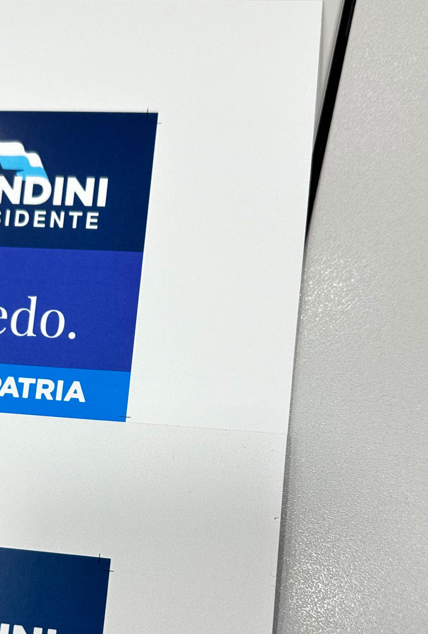

Hello! I noticed another problem in the print quality of our 4100. Basically it is a kind of toner contamination that remains on the entire sheet. I attach a reference image of the same print on our Xerox 80 where the paper remains white, and on the 4100 where the paper remains gray. The problem occurs on all prints, including those from the machine itself, which is why I discard the print server.

I have this same issue with my Versant 280. It looks like your background tinting is more pronounced than what I have. I never had this on my 80 and I still have sample sheets provided by Xerox that were printed on a 180, and they don’t have this background tinting either.
It’s not noticeable on uncoated stock but all coated stock will have a noticeable background tint that is evident when compared to a sheet that has not been printed. I have been given no solution. The only good thing is that I haven’t had any customers complain about it, yet.
Tengo el mismo problema con mi Versant 280. Parece que el tinte de fondo es más pronunciado que el que tengo. Nunca tuve esto en mi 80 y todavía tengo hojas de muestra proporcionadas por Xerox que se imprimieron en una 180 y tampoco tienen este tinte de fondo.
No se nota en papel no estucado, pero todo papel estucado tendrá un tinte de fondo notable que es evidente en comparación con una hoja que no ha sido impresa. No me han dado ninguna solución. Lo único bueno es que todavía ningún cliente se ha quejado de ello.
Yes, our 80 also does it, but to a much smaller extent than the 4100. The 4100 is too much because the white turns out gray.
Does it show on the back side is a simplex sheet? If so the 2nd BTR is not cleaning the roller?
View attachment 292610Also in my versant 180 any solution, i have changed all drums no result
We cleen the suction filter and remplaced the ibt cleaning, It had improved a little, but it got dirty again. We are waiting for an import of the ibt assembly to change it, but everything indicates that it is a contamination problem due to some supply in poor condition and we have to do a decontamination procedure where all the parts are changed, xerox takes care of it but in my case I have what to expect for the parts
