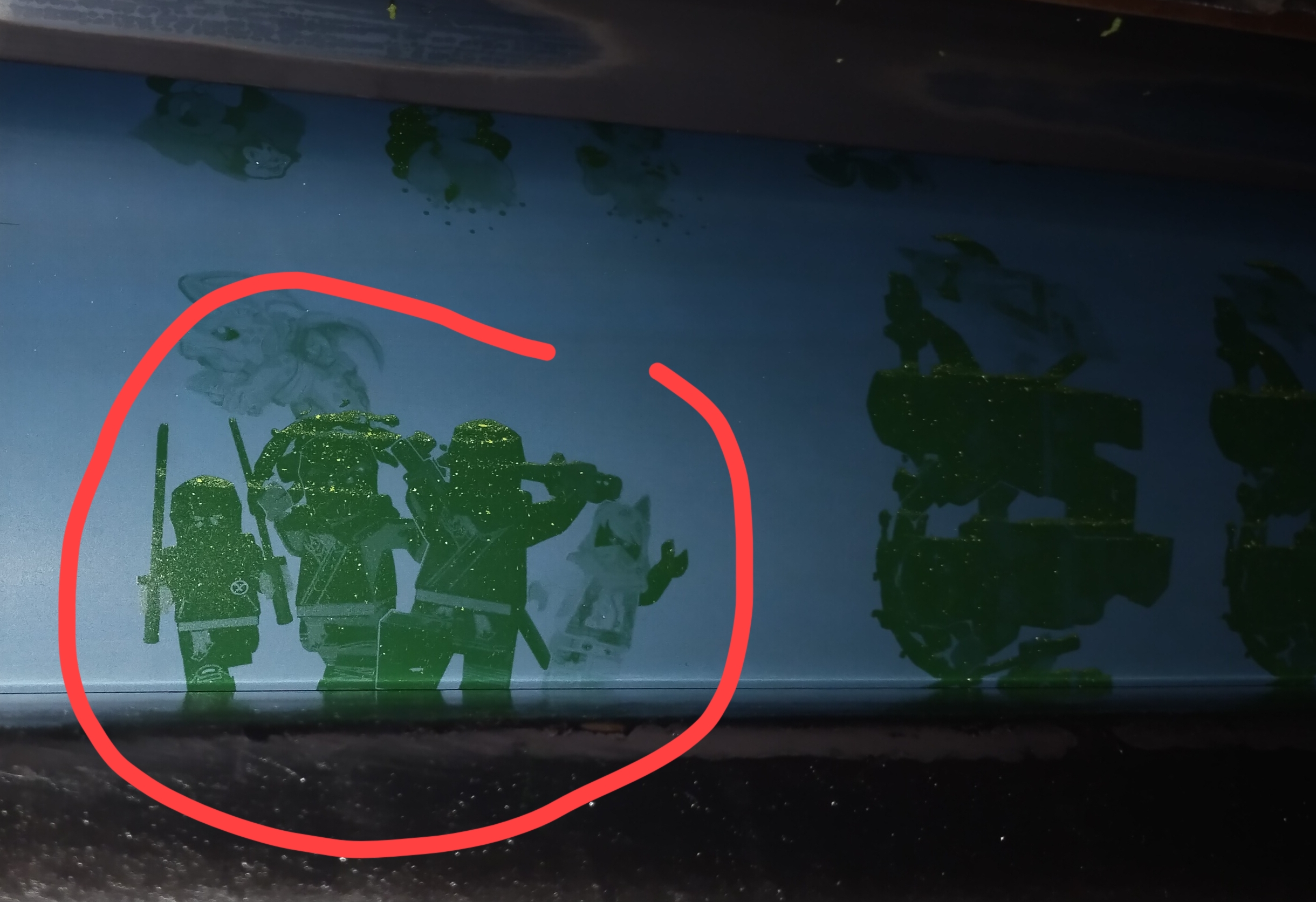

I am having similar kinda problem, piling is seen on blanket in yellow ink more than other colours can anyone please help me to come out of this.
Since it is special inks we cant add any unknown additives in regards to Oekotex and other certifications.
Where as other brand inks has no issues on same plate, same unit
