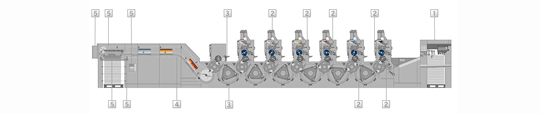

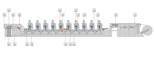

I've attached some cross section of both presses. This will answer your question.
the 10 color is a Sm, the 6 color is a CD
