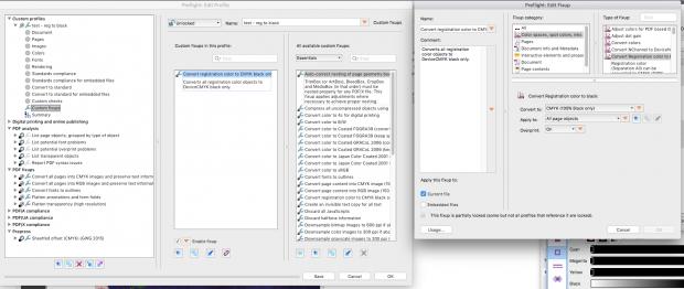

I found this in the preflights in Acrobat DC Pro. Now I will have to put every document out to PDF instead of printing directly to the RIP. It does not appear to work on crop marks for some reason in Acrobat XI Pro. However, I can confirm it does work correctly in Acrobat DC Pro. It's the best I think I might find, which is silly and still a lot of unnecessarily lost click cycles.

Hello Urville,
We have an Indigo HP5600 and we don't get this problem. We have a Black Only RIP folder and a 4Color RIP folder and some other variations so the operator can control the jobs and avoid extra clicks if someone has been a bit lazy with their tick marks. We also use JLT files that allow us to kill off those unwanted clicks.
So I had a look around and there is a Adobe Acrobat PreFlight Profile Custom Fix Up called Convert Registration Colour to CMYK Black Only.
I've attached a copy of the PreFlight Profile and a screen shot of the settings.
You could add this setting to your current Profile or create a droplet app so that every PDF you need processing can be adjusted.
I did a quick test and it worked but there is some talk on forums of it not working for all files in Acrobat 10.

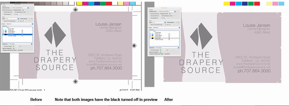

This got me thinkin (and this may be the samething) . . . I looked around and there is a "fixup" in Acrobat DC, "Convert registration color to CMYK black only" run it and the problem is solved . . . working on trying to make it a droplet . . . don't know much about automator either

Dabob, I don't understand how converting to CMYK black solves the problem. CMYK black is still a color click. It needs to be converted to K only to get a b&w click (I think?)
If you look at the "fixs" it does convert it to only K not an rgb black . .. grab a pdf with reg marks then run the registration to CMYK black and then print preview w/black off works great see below
It will only work on the "registration color" - would come in handy for mixed color and bnw work . . .

He is correct, that preflight does convert to black only, but I cannot for the life of me figure out howe to make a hot folder for DC PRO in Windows 7. I use actions in Acrobat DC PRo all the time, even hot folders for the rips, but I cant seem to find a non convoluted method for DC Pro
I didn't make a hot folder, I made a droplet that I can drop multiple files on and have them show up in a folder of my choice . . . not quite as elegant as a hot folder but better off than I was last week . . . and a month ago I had about 100 variable jobs that were color on the front and K on the back . . wish I had known about this then . . . . oh well, live and learn
