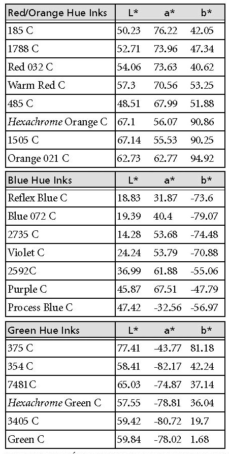

Here are some ink colors that are commonly used to expand the CMYK gamut in a 5, 6, or 7 color process.
So you need to work with your ink vendor to make sure that the ink is formulated for your application.
