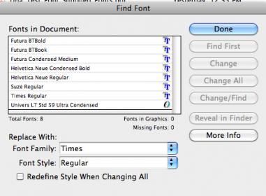

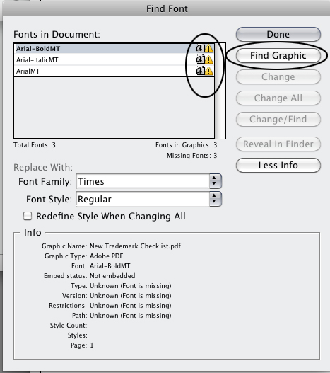

When you look at the font usage palette, fonts used in images will show up as a separate icon than the fonts used for the document. It will also tell whether they are missing or not. My guess is that the barcode your client is using has the font information embedded within it, which when it's placed in InDesign is fine the way it is. However, since the font information is embedded within the file, it's going to try to look for those fonts when you try to open it in Illustrator and they will show up as missing.
