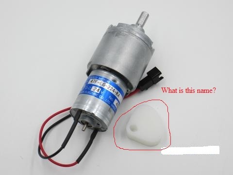

My Screen PTR 8300 door lock unit got problem.
The white item in at my place got crack. What is the name for that? Is that possible to find a replace just for that rather than motor? My motor ok, just that white item crack only.

DN+70510786 CAM SHUTTER OPEN/CLOSE 70510786-00 SHUTTER DRIVING CAM POM 28.19*25*9.5
Ask dealer of Screen, Agfa, Fuji. Better to DIY, it is easy to make with file, sandpaper and piece of hard plastic.

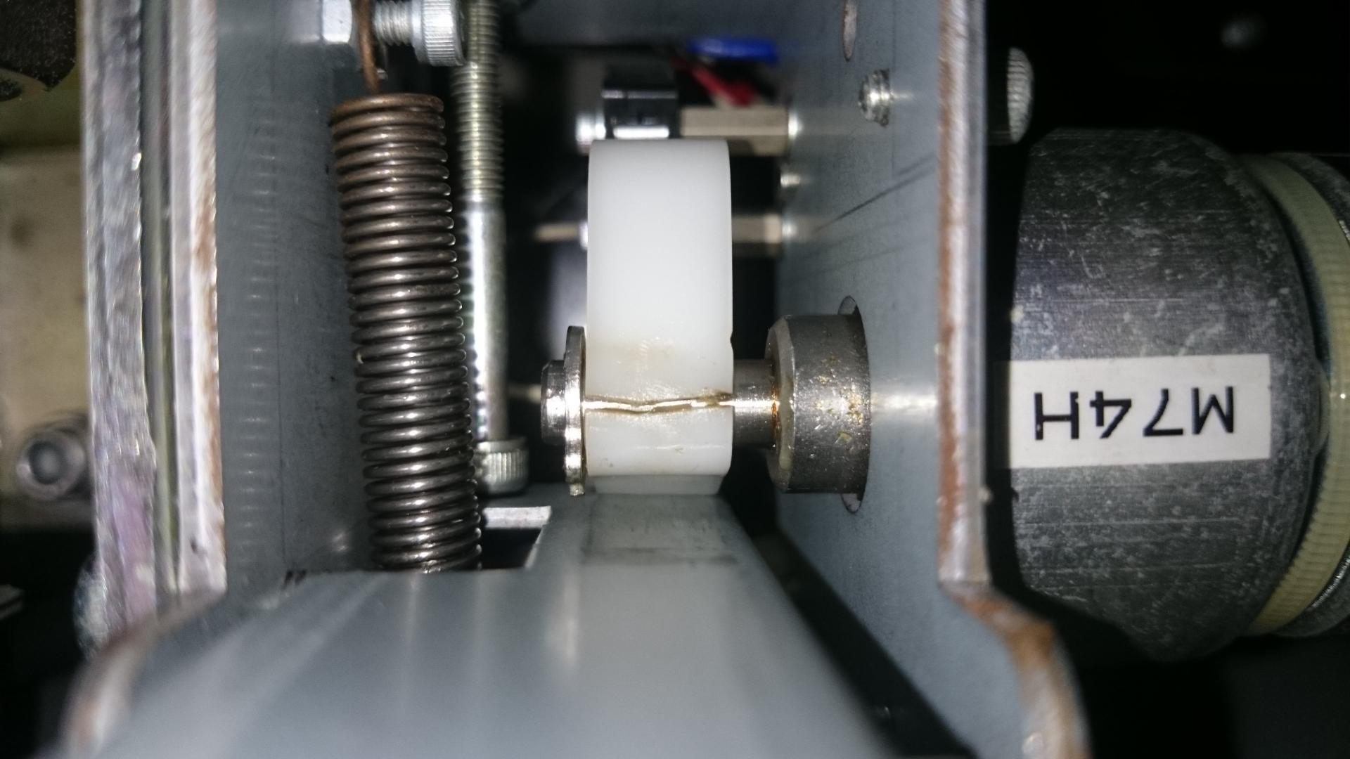

As you can see from attachment.
It is cracked and now it is not able to push the lock so I always have to manually open it.

Here can't find the 3d printer supplier.
ChrisZ says it is easy to make with file, sandpaper and piece of hard plastic. How to do it with that?
You take old part as a template. Work with some tools to get proper shape.
I see, that you have no idea about that, maybe you could find some workshop, ironworker etc and ask to duplicate that part.
