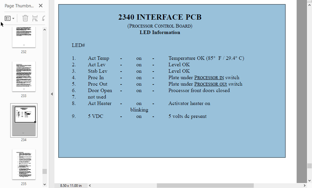

smalloffsetpressexperts
Check the board LEDs
