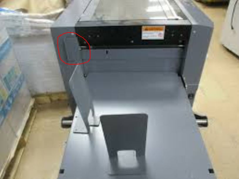

According to this brochure from the Duplo website, it doesn't. It would be listed under optional accessories like they do for the 616. And in the photos of the exit tray, I don't see where the perf attachment would connect. There's a small panel on the left side of the exit side of the 616 that you remove to reveal a gear that the perf unit engages with externally. See attached photo of where the panel would be. If your 615 has the removable panel, then maybe it could work with the 616 perf unit.

Thanks for the info. I don't have one currently, we run a weekly perf job that we purchase pre-perfed paper. We'd like to get an SCC to handle it and then automate book cover scoring. The person selling it also said their in house tech said it can perforate. So I'm guessing it does unless I got 2 different people today lying to me.
