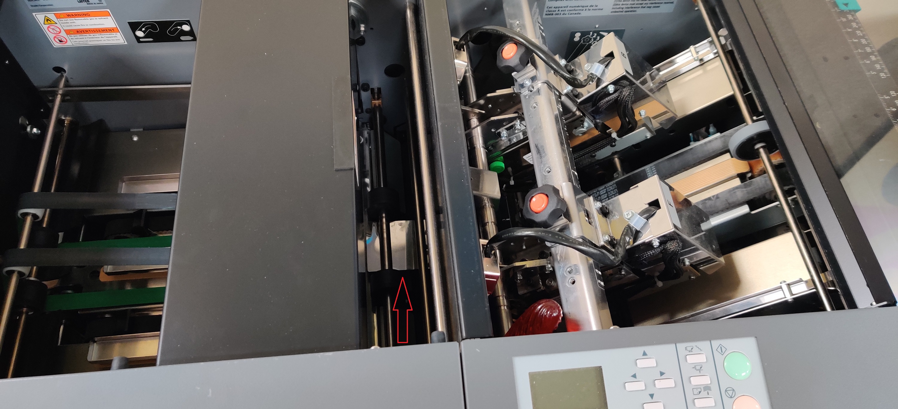

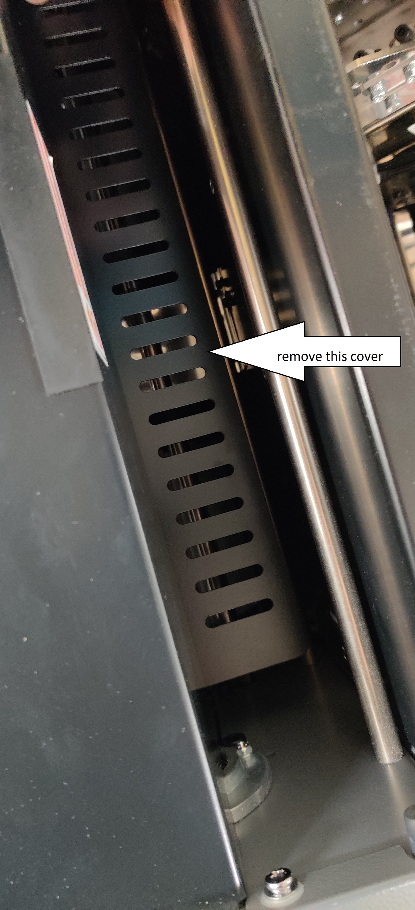

We had a similar issue a few months ago. There's a silver plate before the trimmer that is designed so pieces can't go up, but the set screw came loose and it ended up blocking all the pieces. In our case it actually fell off and got stuck under the knife. If you look at the photo you can see it's a little banged up.
Here's some photos to help. It's a pain in the butt to access the screws, just as a heads up. Not sure if this is what your issue is, but it's worth checking out.
View attachment 293545View attachment 293546
