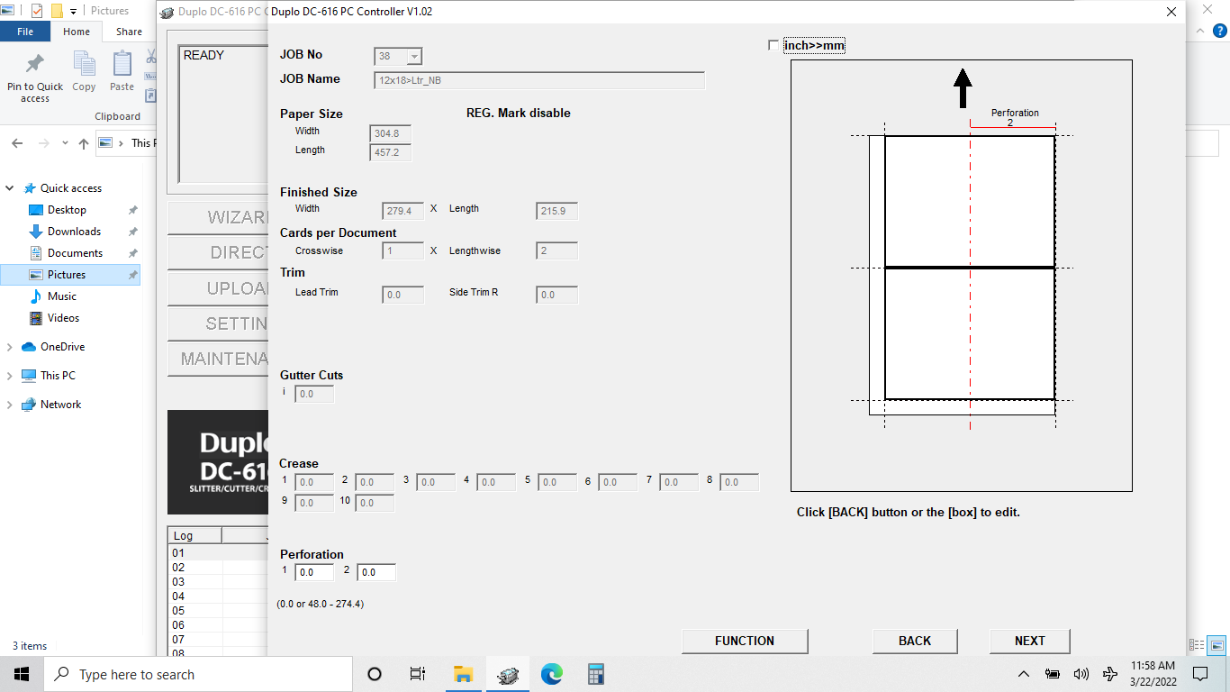

Hi all, new here. Is there a way to do a ‘chop cut’, no gutter cut on this duplo? Or do all setups require the minimum 5mm gutter? Thanks! steve
TJPrinter
Yes, you can have gutter slits and gutter cuts set to 0. If you did want a gutter, the minimum gutter cut is 3mm and the minimum gutter slit is 5mm. At least that's the way it is on the 618 and I believe it's the same on the 616.

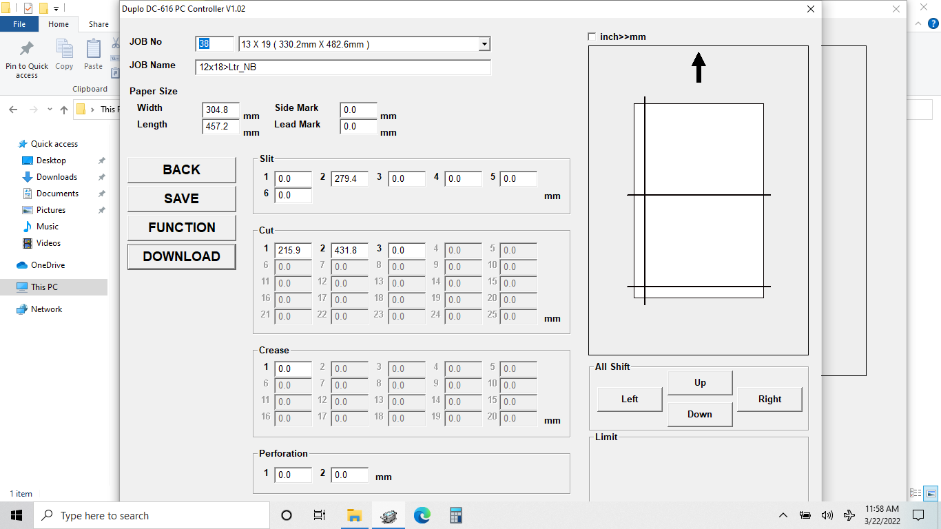

I'm getting some kind of error when I set gutters to 0. I have a set up to cut down blank 12x18 to 9x12 or 8.5x11 (12x18 130# doesn't run well through my printers). I only get one sheet out and there are many cuts afterwards, I'm guessing to drop the "excess" to the garbage bin?
YourCastle
Thanks!
jwheeler
Try changing your side trim to .5" (which is 12.7mm). If you still get the error, change your lead trim to the same. Changing the lead trim should also eliminate those multiple cuts you're hearing at the end of the sheet. That's just the machine shredding the paper down to smaller pieces to ensure they fall into the waste bin without getting stuck.

Changing side trim didn't work. Changing the lead (by itself) did! I was hoping to reduce the need for the initial cut, but this is better than the program I have for full-bleed.
If you want to cut 12x18 into two 9x12, "auto cut" has to be turned off in the template in "FUNCTION" -- or do it in "SETTINGS" after the template is saved.
From the manual:
Auto cut
Lead margin and trail margin are finely cut and dropped in the waste box.
When documents do not have lead margin or trail margin, this must be turned off.
YourCastle
From the manual:
Auto cut
