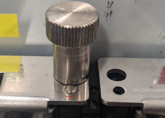

my guess is you have a module that isn't sitting all the way down inside, or you have a roller (or rollers) as your culprit
pins full seated and thumb nuts snug:

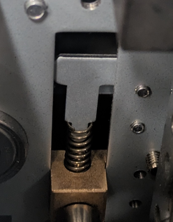

either one or more rollers aren't touching all the way across
roller bearing rider should be equal on both ends of roller:

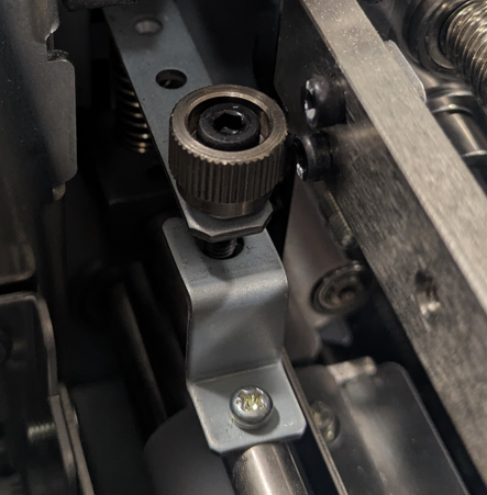

the tension is different across one or more rollers
thumb screws should be equal in adjustment:

The module mounting surfaces do not seem to be damaged and they are seated correctly. It probably is something with the rollers. I adjusted the thumb screws to as equal tension as I am able to. How tight should this be? The other areas you've shown in the second image look even to me, but maybe I am not seeing it well enough.
