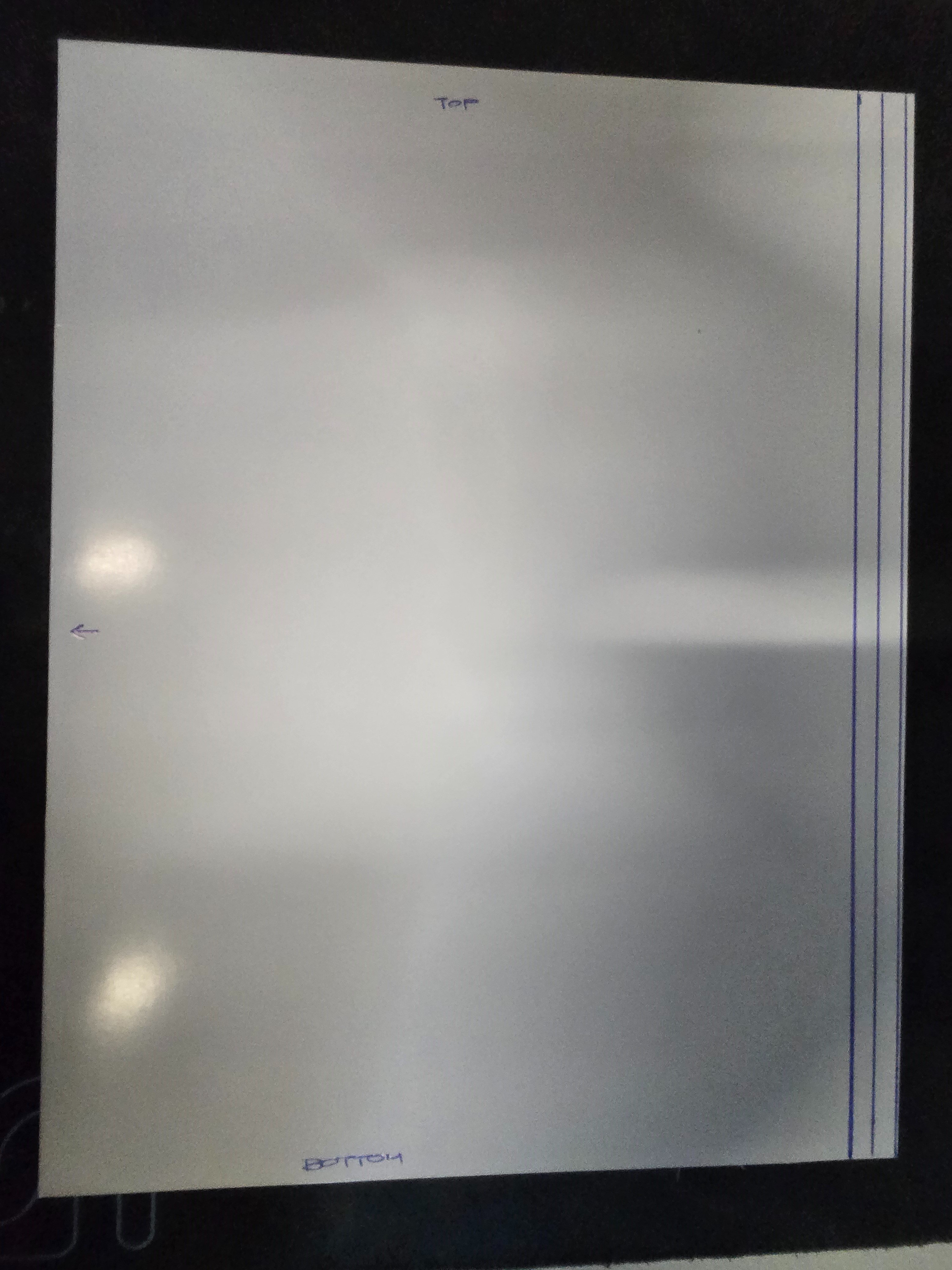

I have a Plockmatic 350 booklet maker with a square fold and face trimmer that I'm using offline. Ive been having an issue where the facetrims are slightly skewed top and bottom. I've been been having to take my booklets and face trim them afterwards through our cutter. Is there a way to adjust the blade angle? It's roughly 1/16" longer on the top cut (inboard side of the machine) than the bottom. Please advise. TYIA

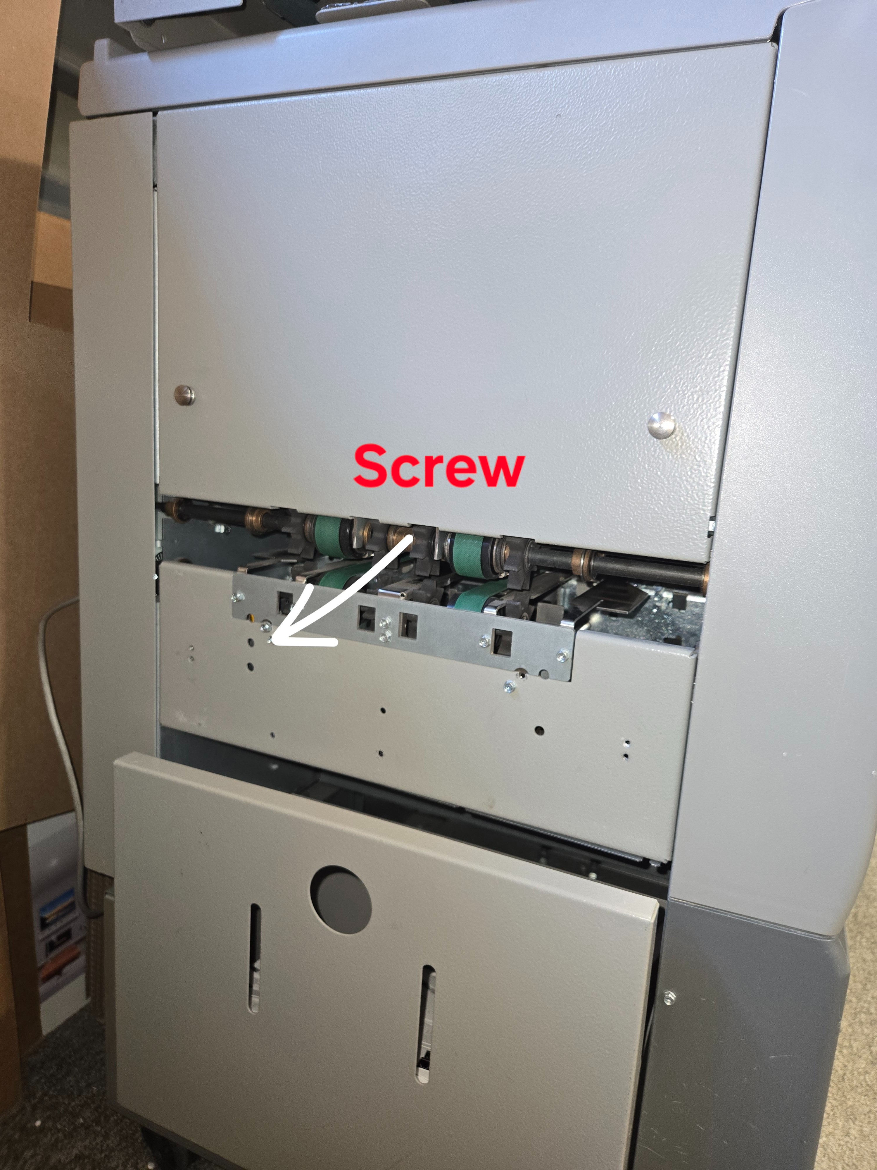

I was able to resolve the issue on my machine. This is how I was able to do it... hopefully it helps someone else out.

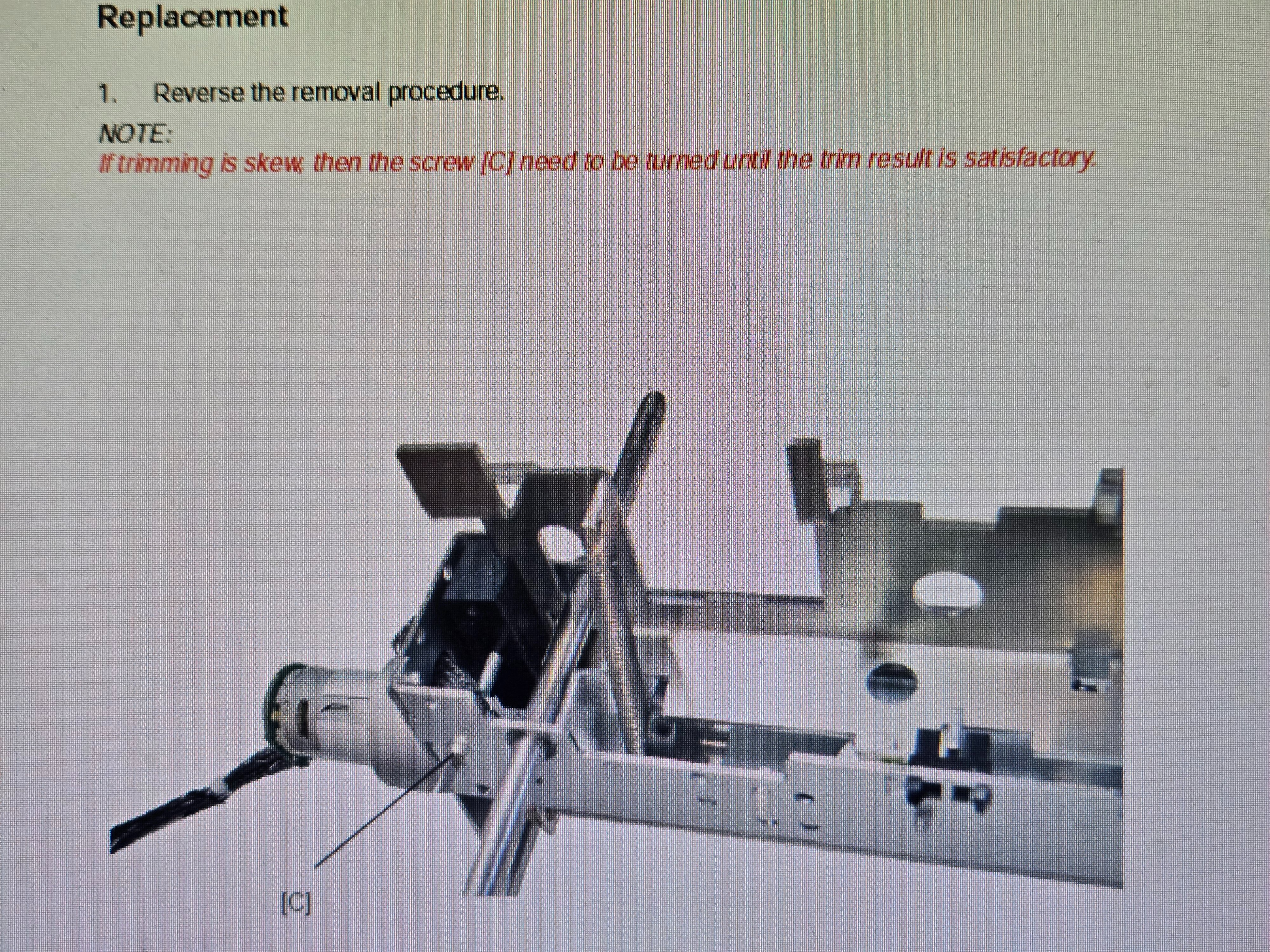

I read the service manual but it did not give direct detailed instructions. I only noticed when I was reading on how to remove and replace the gate carriage that it was written as a side note "If trimming is skew, then the screw (C) needs to be turned until the trim result is satisfactory." This is in page 3-84 of the service manual incase anyone wants to take a look. It was, however, confusing because the part they were describing was already removed in their illustration.

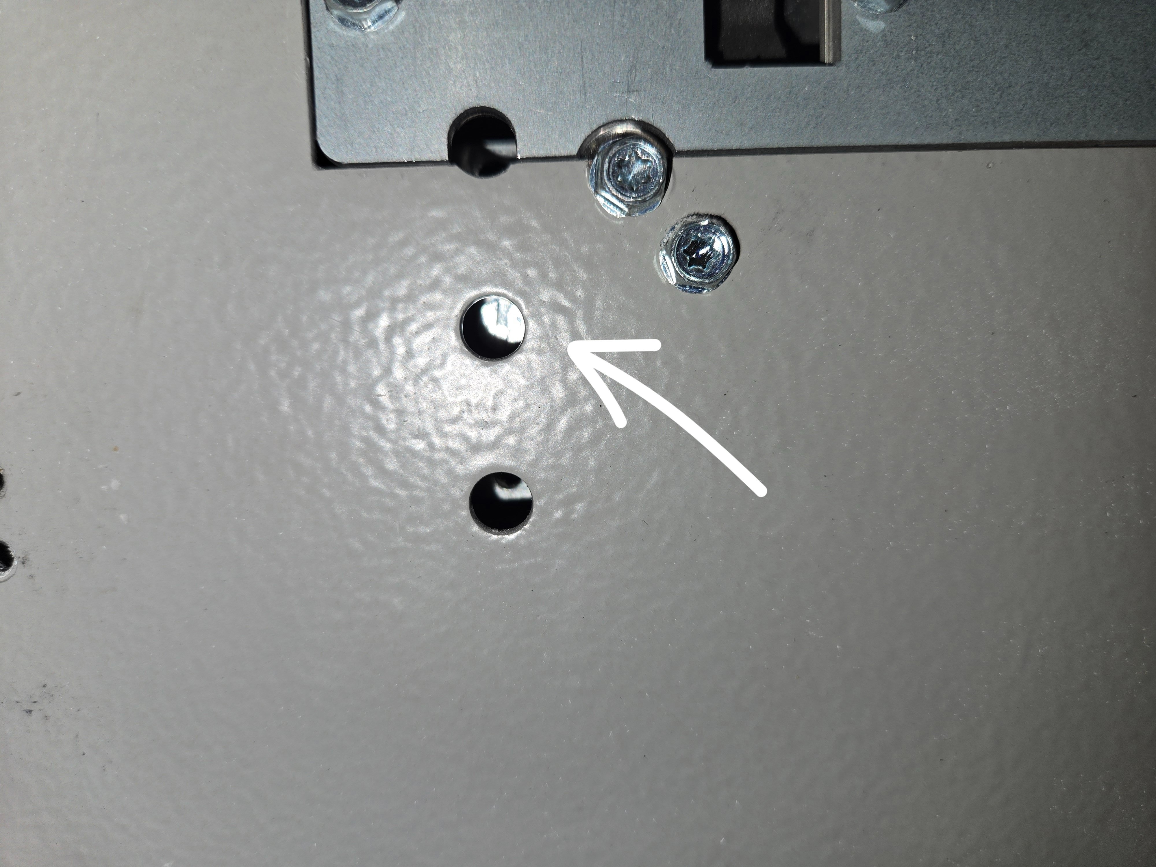

I was able to find the part they were describing without removing it from the machine. If you remove the exit tray from the trimmer, you will find several holes. One of the holes towards the back machine has a flat head screw right behind it. By turning this screw slightly, It allowed me to adjust the trim.
This helped my issue, hopefully if helps someone else out.
