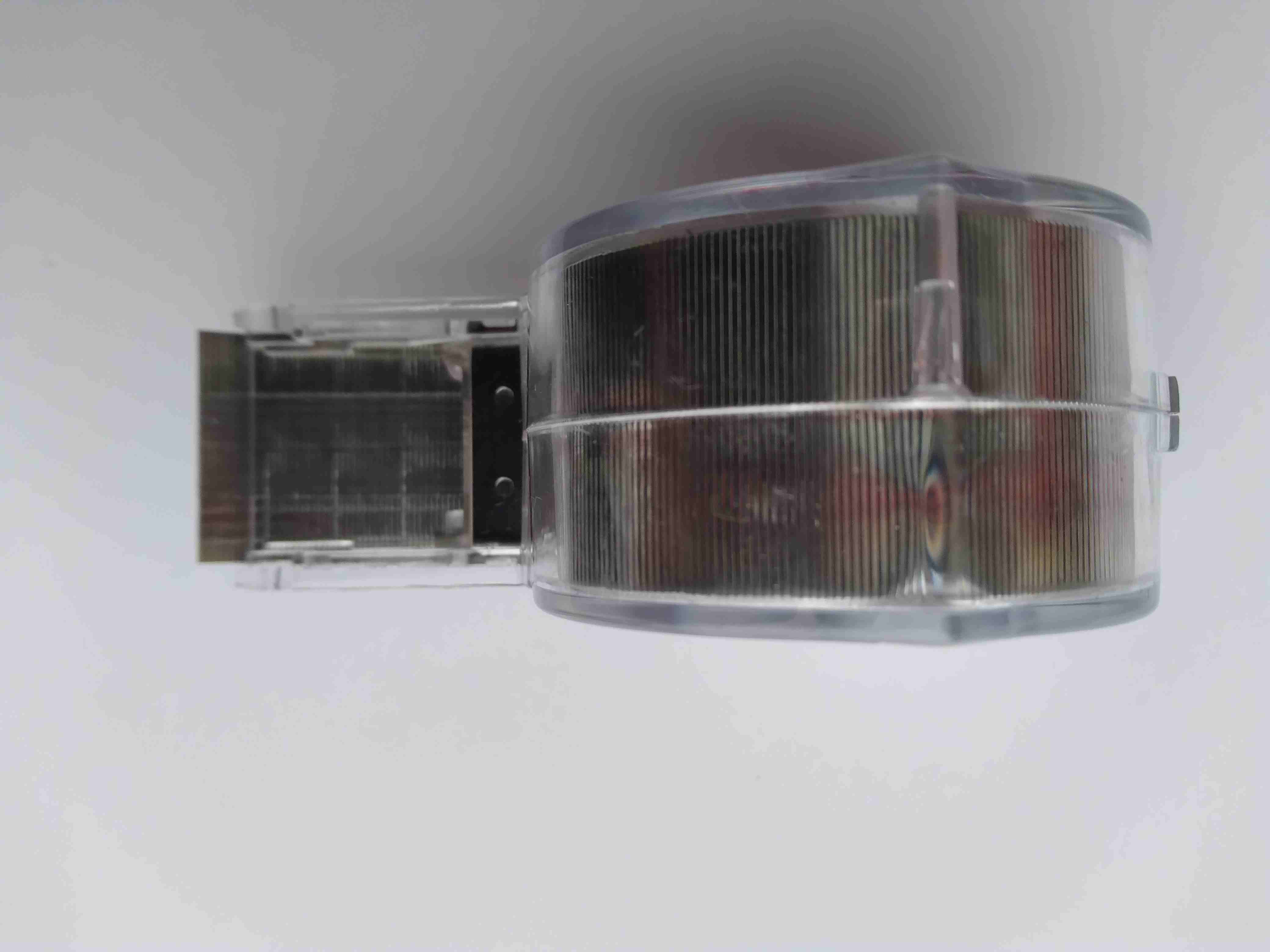

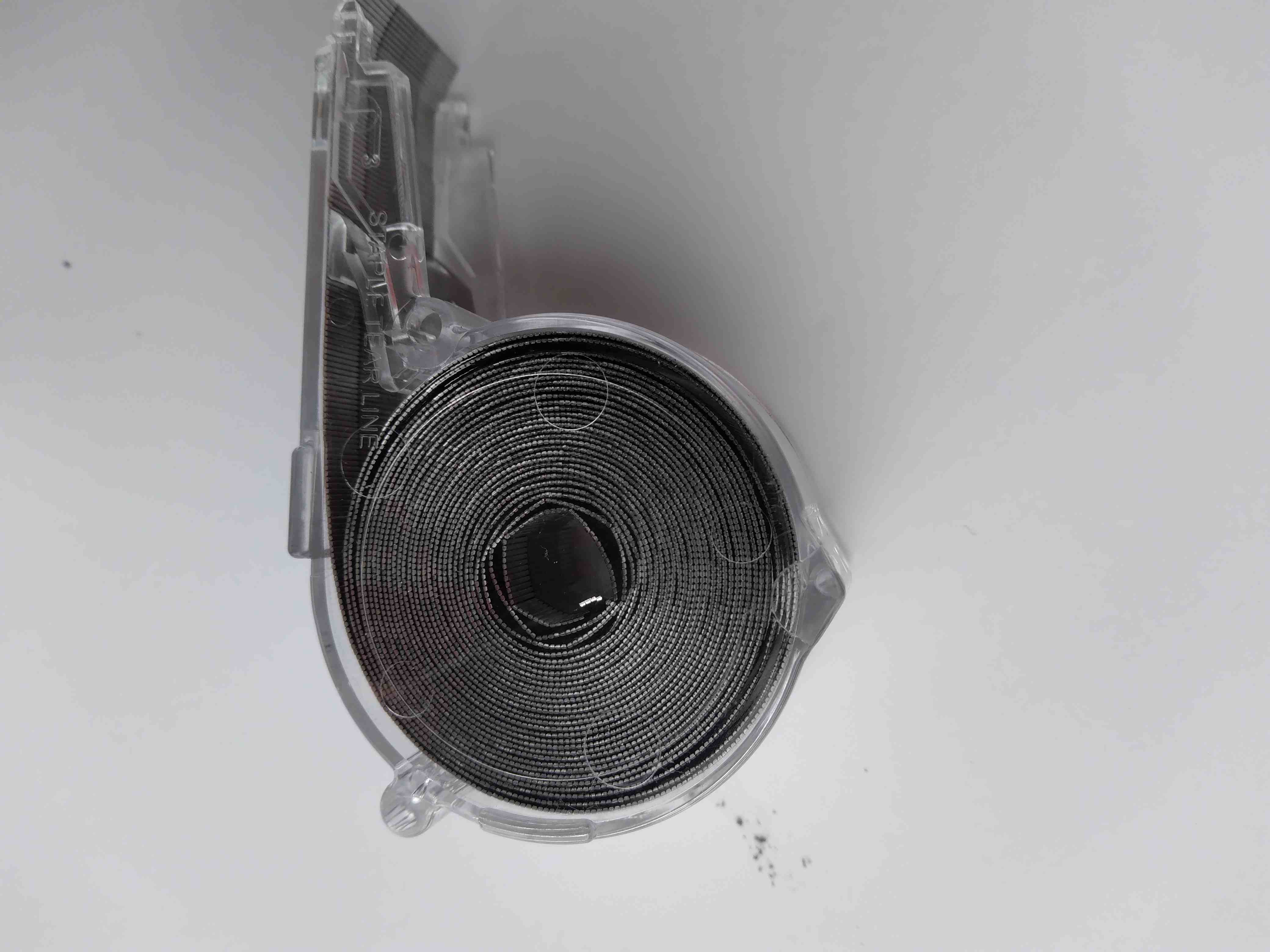

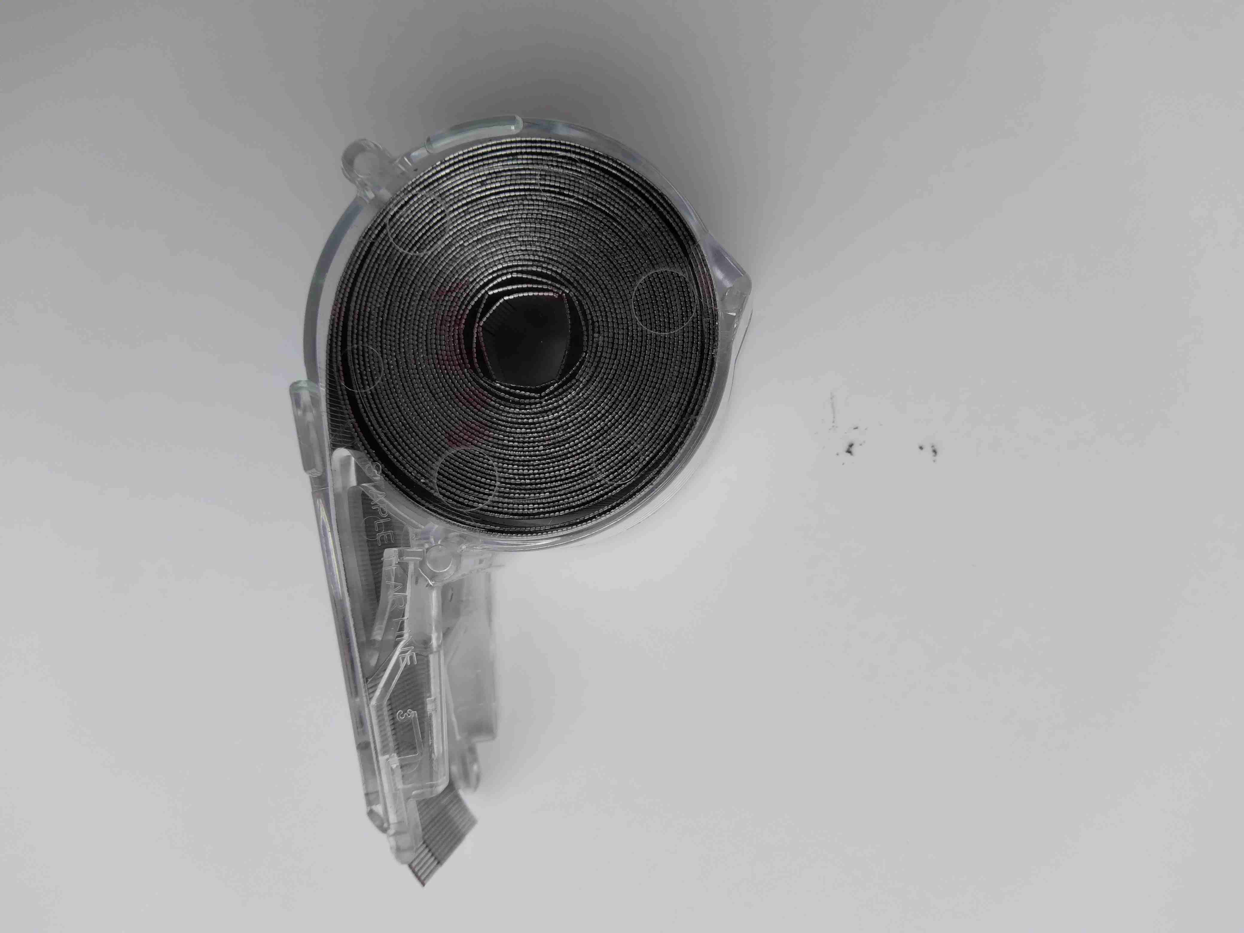

Can you take a picture of what these staple cartridges look like?
Just the standard Duplo snail cartridges. See attached. What would be fantastic! is if anyone had some old stocks of these, they would be willing to sell? As long as they were more than a year old. I never had a problem with these until the batch I purchased about 7months ago.
