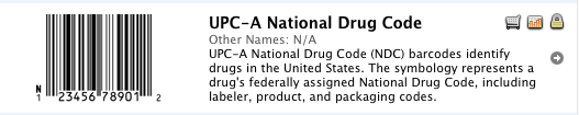

I just looked again in the barcode software, and scrolled a little further through the types, and there actually is a "UPC-A National Drug Code" variant and it does add the "N". That's the type you want.

I'm pretty sure that this is an NDC/HRI code not a UPC(A). This type of code piggybacks on UPC(A) specifications. Here (nih.gov) is an incredibly verbose article about it that I didn't bother reading. DynamicBarcodes can output this type of code.
