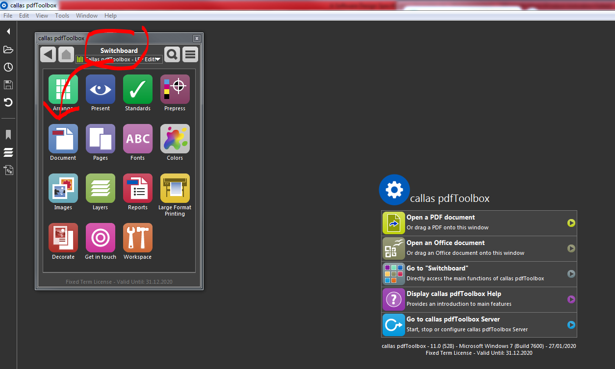

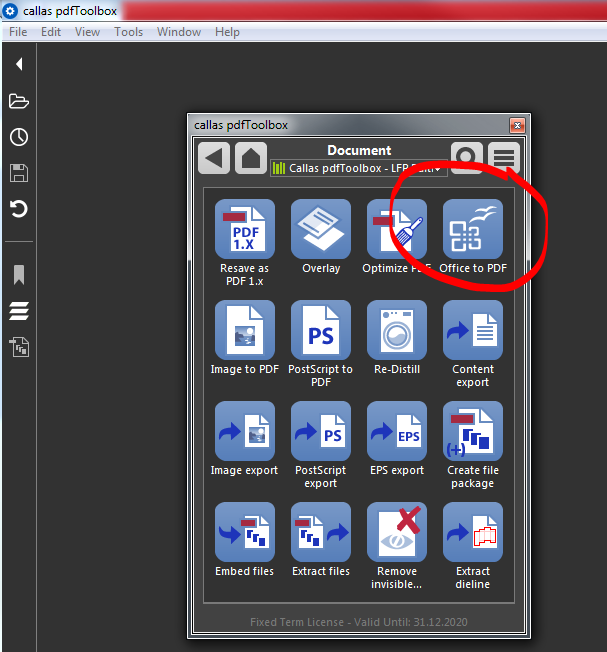

Callas pdfToolbox Desktop can be a solution. It was around 500 EUR/USD last time I've checked.

We get these from our customers too...and we have KM printers. I have 2 quick fixes that work for 99% of the jobs and they don't require PitStop or any other 3rd party software, just Acrobat Pro. Go to the Advanced menu and select "Preflight". Assuming you're running digitally, select the "Digital Printing" category, then "Digital BW" or "Digital Color". Then select "Analyze and Fix". This usually does the trick. If it still doesn't work, then in the Adobe Acrobat Print dialogue box, click on "Advanced" (bottom left), then check the "Print As Image" box at the top. For small text, I usually change it to 600dpi. It will take a bit longer to RIP this way, but it's essentially the same as rasterizing/flattening in photoshop.
