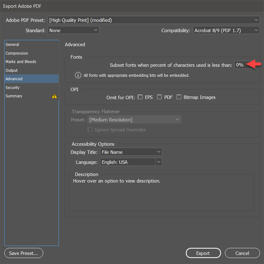

The first value is in the Advanced tab of the Export Adobe PDF dialog; this should be set to 0 to force full font embedding. (The default value used with all the predefined Adobe PDF Presets is 100 which indicates that subsetting is to be employed unless the document actually references all the glyphs in the font.

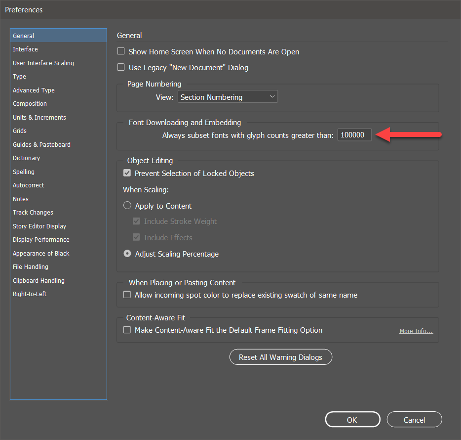

The second value which overrides the first is in the General tab of the general InDesign Preferences. There is a setting for Font Downloading and Embedding. Always subset fonts with glyph counts greater than: where you specify the maximum number of glyphs in the font that will allowed to be fully embedded.
Depending upon how long you have used InDesign, you may find that this value may be defaulted to 1000 or 2000. Thus, if you have a font that in total has more than that number of glyphs defined, that font will always be subsetted in the PDF file. 1000 or 2000 glyphs may sound quite a large number, but with many modern fonts, that is definitely not the case. For example, many of the system fonts in Windows (including Arial, Times New Roman, Calibri, and Palatino Linotype), many so-called “Pro” OpenType fonts, and even many Google fonts routinely have many thousands of such glyph definitions to accommodate numerous international character sets (including Cyrillic, Greek, Hebrew, Arabic, etc.). If embedding “full” fonts is that critically important to you (separate issue), then perhaps a value of 10000 might be more appropriate here.

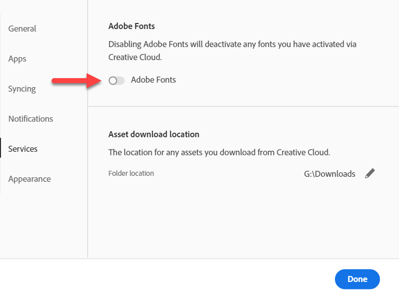

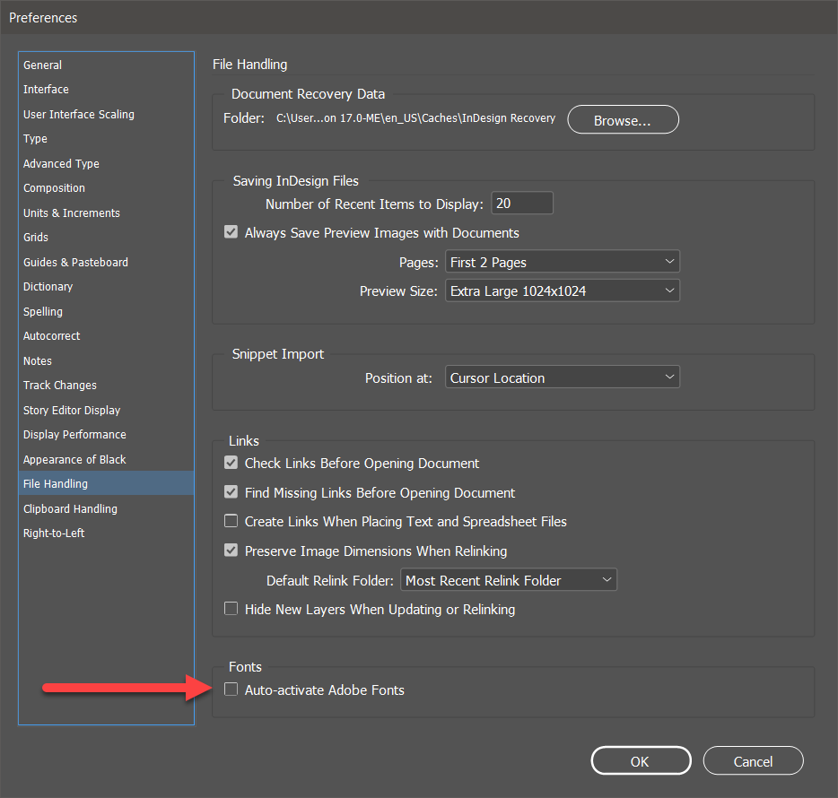

And if you do have not disabled the Adobe Fonts Service, for further protection, you should check your InDesign Preferences and and make sure that the Auto-activate Adobe Fonts option is disabled:
A similar option is available in Illustrator. (I haven't found anything comparable in Photoshop at this point!)
Thus, assuming that you are using a reasonably recent version of these applications (i.e., within the last two years or so) and you have turned off the options I've pointed out above, exactly how can you say “that controlling/renting their fonts is absolutely something they are doing right now?”

In terms of the “overhead” at RIP time of having a full font embedded, that is really insignificant. As far as I know, RIPs simply store the font definitions when encountered and don't do any real interpretation until specific glyphs from such fonts are accessed by the text being rendered.
- Dov

However, there is one other important consideration. Unless one is embedding a full OpenType font (an option in Distiller, but not otherwise available in other applications), even if the “full font” is being embedded, it is only the glyph definitions and the advance widths that are being embedded. The other OpenType tables for kerning, alternate character mapping, etc. are not embedded. Thus, any editing that is done with such embedded fonts is problematic anyway in terms of quality.
With regards to EPS files, it depends what makes the EPS files. Typically, subsetting is done for EPS files as well.
- Dov
