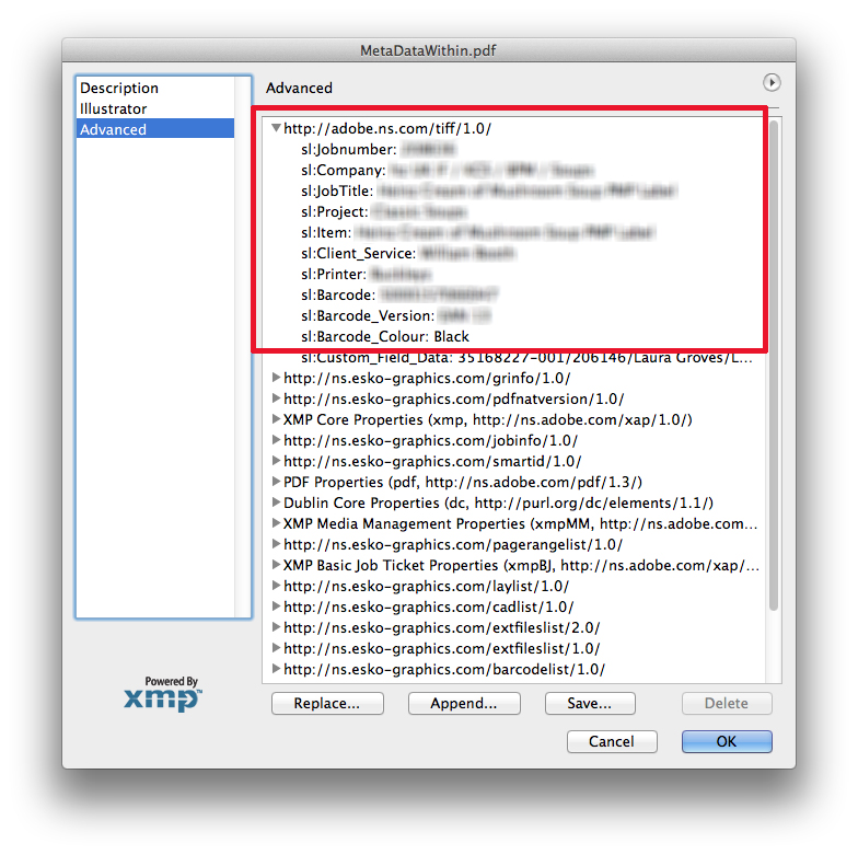

Thanks for all you advice. This is a scrnshot of what I'm trying to achieve.
It would appear that getting the custom fields into the PDF is “relatively easy”. How does one automate the process, so that a certain job in the MIS populates the PDF with this info in an automated or semi-auto routine? What if there is no live link built into the MIS to apply the MIS metadata to the PDF from within the MIS? If one can only export out a XML/JDF file, how is this applied to the PDF? How does one ensure that the correct XML/JDF file is linked to the correct PDF and that the correct MIS fields are applied to the correct fields in the custom PDF panel?
