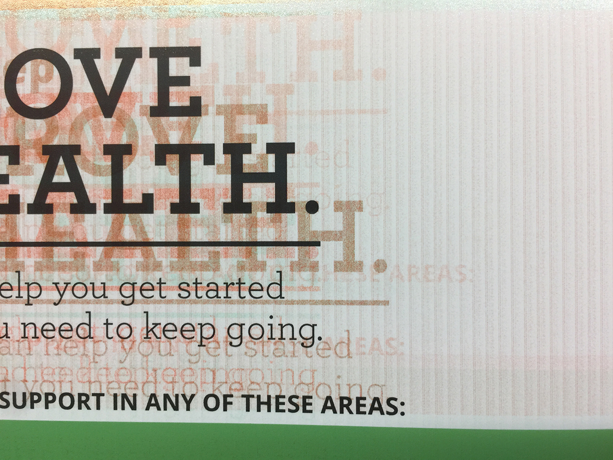

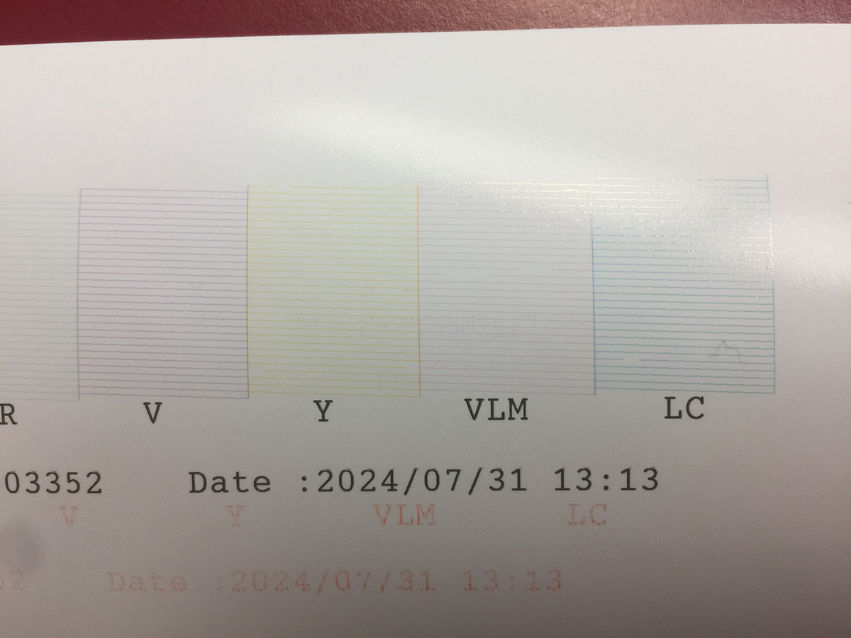

We don't run it a lot but I do nozzle checks almost daily. It is a gently used machine. A few days ago the nozzle check looked like the nozzles were out of register. See attached image. Does this look familiar to anyone?
What type of problem am I looking at? Additional image shows black type on a white background, but ghosted type is all over the place.
I tried print head alignment in the maintenence menu but it does not seem to change anything. Is my print head shot?

That image shows a ton of mis-registration. I would try doing an AUTO head alignment as well as a feed alignment.

EPSON: We would advise to do a print head alignment. Please refer to page 165 in the user guide:
This is for the SC-P7000.
This worked for me. Under step 7 I used the fourth bullet point. Bi-D #1 thru #4. Proofs are in register now!
