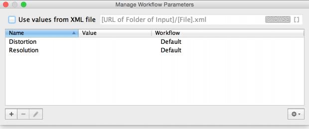

This can be done with using "Workflow Parameters" with a router.
If you upload your current Workflow I can make it happen for you.

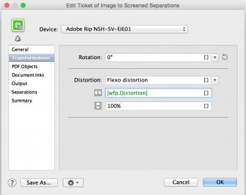

Screen Shot 2015-10-07 at 7.58.02 AM.png.jpgScreen Shot 2015-10-07 at 7.53.41 AM.png.jpgScreen Shot 2015-10-07 at 7.53.27 AM.png.jpg Screen Shot 2015-10-07 at 7.53.36 AM.png.jpg OK, devin is correct. If you don't have JDF / XML integration you can do this with workflow parameters. Whenever you create a workflow parameter it automatically becomes a public parameter. Therefore the operator will be prompted to fill in values via shuttle launch.The nice thing is that the workflow parameter is like a stored variable. So they will only need to enter it once and you can use that variable anywhere in the workflow. I have attached a few screenshots showing what I mean.

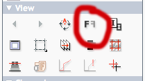

Colorblind- We had our workflow setup to output a right reading and mirrored output many years ago. What we found to work instead was to just RIP the LEN files for the CDI and just use the viewer to flip the view for verification. We found it confusing to have both views for QC, especially on jobs that were mirrored print or had both surface and mirror print. It was also another file to maintain, so storage space. And we ended up being more comfortable having QC looking at the actual files going to the CDI as there is no chance for the viewing file to not match the CDI file. Again, just an option for you. And Im sure you know where to flip in the viewer but am including a screenshot just in case.
