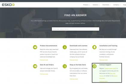

Another venue for answering questions about Esko products is the Esko Users Forum. You can get to it by going to http://esko.com/support and clicking on "Esko Users Forum" under the Support area. (see screenshot ) You will need your Customer ID to register for the forum. Right clicking on the task that is erring to get the log info would be helpful as WI mentions.
