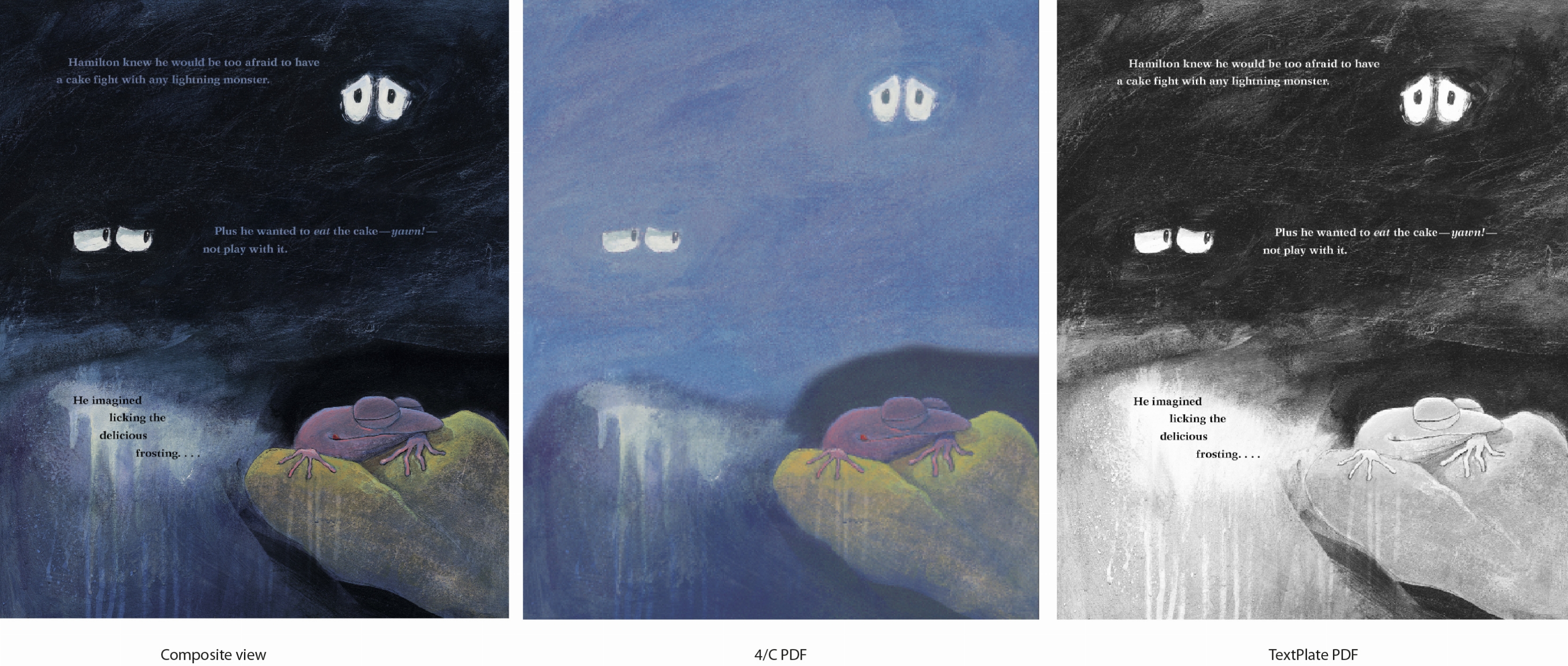

Please see the attached JPG. The image on the left is a Composite PDF which contains CMYK+TextPlate. With Pitstop (or Acrobat DC) is it possible to create 2 PDFs from this single PDF; one being the CMYK and the other being the TextPlate (as shown in the JPG). If it's not possible in Pitstop, is there any software that will do it?

Yep, you can do it in PitStop Gregg, if you can send me a sample file I will mail you back and Action List
