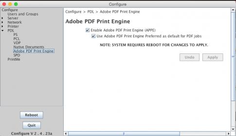

The FS100 has APPE too. You can choose it in the options for a job, or set it as the default. Using APPE, we don't see the transparency issues we used to with older Fierys (which mostly involved transparency interacting with spot colours).
Really? I will check that out today. Thanks.

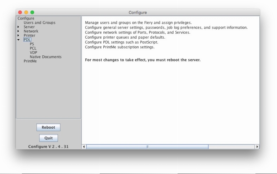

Do you have a screen shot where these settings are? I have looked everywhere in my Command Workstation (ver. 5.0.8.39 SP2) and do not see any mention of APPE anywhere.
Yoda Voice >Hide it they Do<......Server>Configure>PDL>Adobe Print Engine
No setting there for me. We must have gotten the bargain basement edition.

We have the Fiery FS100 Pro - Maybe APPE is just for the Pros?
